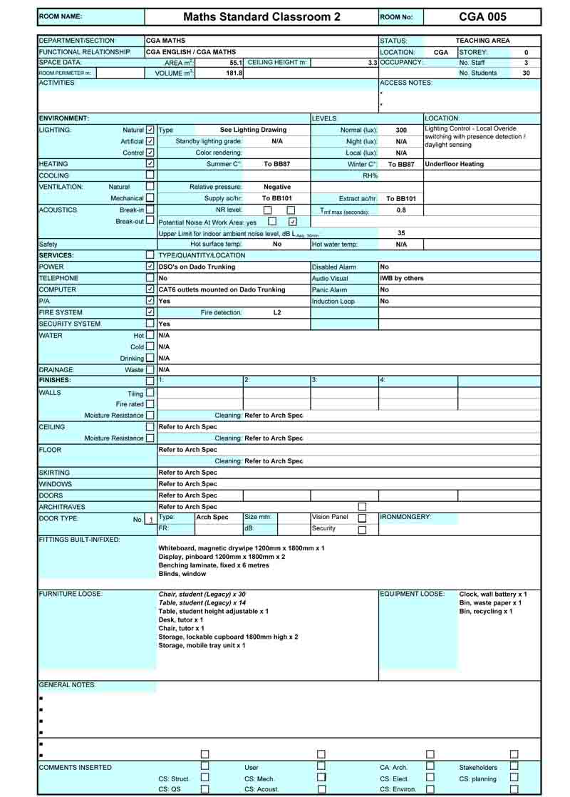

Basically, I'm trying to create sheets like the one attached, the data being held in the Revit model in the Rooms.
I don't think I can create sheet like this in Revit, only a schedule ? And so to create this sheet I'll have to output the scheduel as an Excel file and then use Word / Excel to create the sheets - I'd use the method I detailled in post 1 above.
Or am I wrong on this?

I wish you had posted this at the beginning.
Because of the special formatting, this has to be done in another program but you could export your Revit information by room and set up your excel file to read the data from each export automatically.
