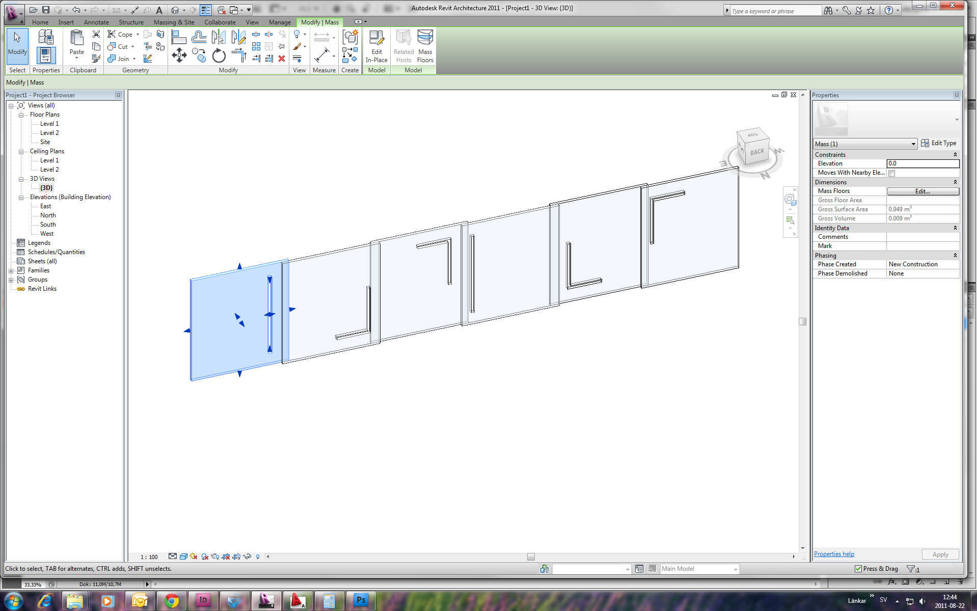

I have an issue that might be very easy and obvious to you, or maybe I've misunderstood the concept of in-place mass and then it won't be solved. Anyhow, I have made an in-place mass that is supposed to be a sketch on 6 doors in a custom made cabinet (i'll attach an image).
My problem is that, as they are now, they aren't of any material, meaning they are see-through and won't render, for example. Properties isn't giving me anything to change and using the "add wall/floor/curtain wall"-option is not what i am after. So, is there anyway to just "fill" these transparent shapes with a material?
Thanks in advance

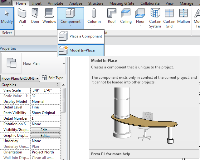

Why did you use a mass when it is a cabinet?
If you want an in-place family, then do that and make it be the right category.  Then, as you create the solids, assign a material to them.

See attached image, you should have modeled this as an in-place component not a mass.

Managed to figure it out eventually and created a new family with material parameters.
Good advice, thank you!
