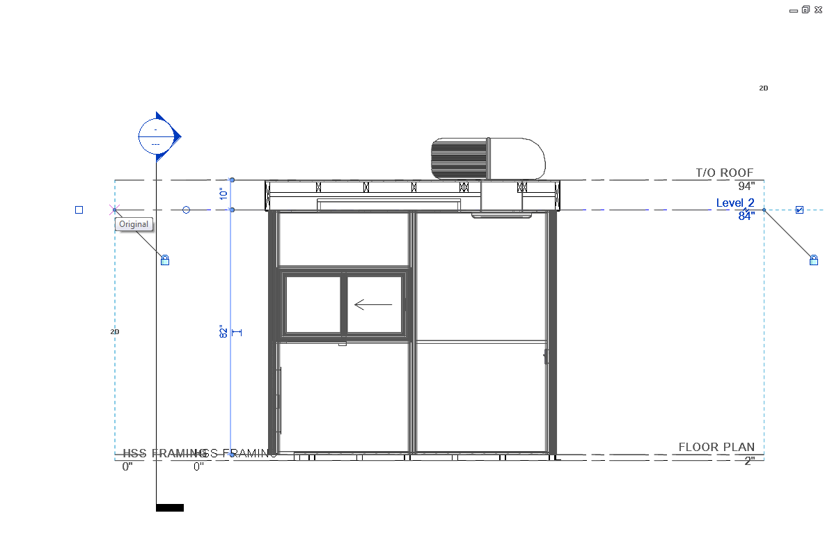

I'm running into this problem with my levels not showing up in elevation.  The level is there, when I hover over the area that level is supposed to be with my mouse, it shows up highlighted.  Even when I click on it, it displays.  But when i move the mouse the level is hidden.  I checked the vg and everything is all good.  I have other levels that show up but not certain ones.  I've also tried the cropped region thing that others suggested and even unchecked the far clip active box that other suggested also.  I'm running out of ideas on how to solve the problem.  Can anyone please help me

I seem to 'loose' my levels quite often. I find that usually my level lines don't extend far enough in one direction to show up in the elevation. The level lines need to be cut by the elevation box to appear. try cutting a new section right through the building, this should show all your levels, and then drag the level line WAY over. Then just delete the section view you created. I hope this helps.
