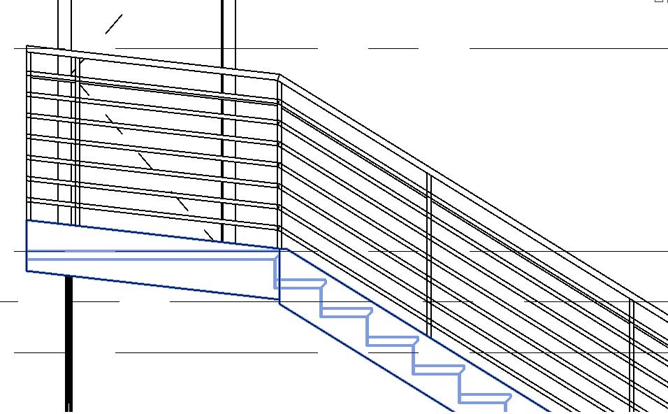

I know that I have been able to do it before but I can't seem to figure out why it does this. I am trying to extend the top of the stringer a distance of "X" but it thinks of it as another riser and slopes the stringer to the end of the extension. I have the "end with riser" unchecked and I split the stringer lines 2" from the nosing. All I am wanting to do is have it go straight out from the nosing. i am working on a 20 flight stair and many of them require this condition. and I need the full 12" stringer profile to extend as well. I can always just model-in-place a stringer but I think it looks better to be part of the flight.

Nevermind. I extended the "run" line and it worked for me.

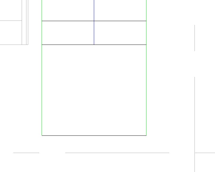

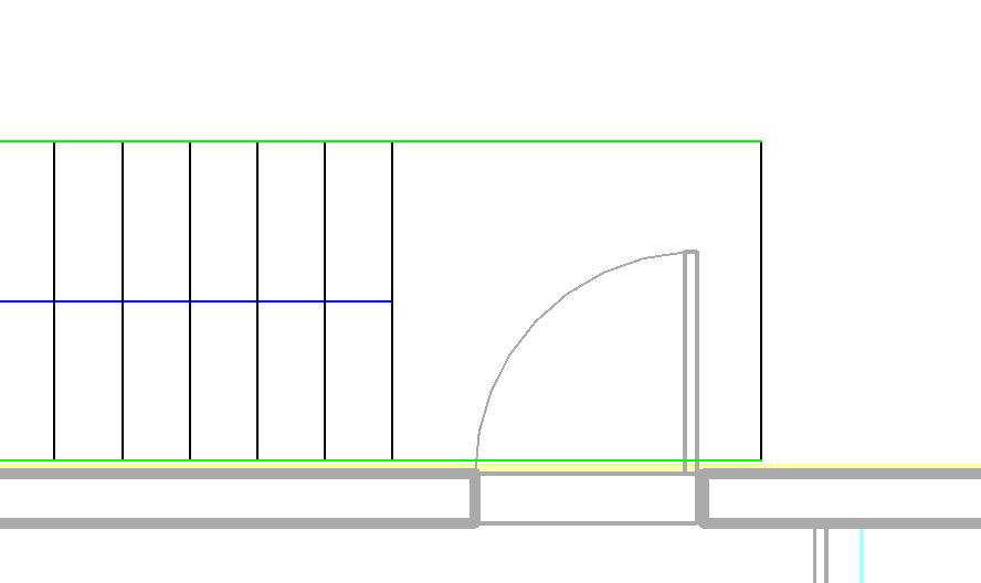

I am having this problem too but when I try to extend my run line to my top landing it just creates more treads where my landing was.  (My staircase is not a scissor stair)  I attached images.  Thanks!

@durangoarchichick Second image: the line on the far right is a riser line, make it a boundary line.

I tried that but this message pops up: "Stairs require no less than two boundaries (chains of one or more Boundary Lines)." Then it won't let me finish sketching.
Wed, Dec 14, 2011 at 10:39:13 AM | Stringer Haunch (level off) at top of flight
You don't want to use a landing here.  I know, it is one!.
The problem is that with these type of stairs, the stringer will go along all sides of the landing and you don't want that across your opening.  We use a floor here and add the channels along the two sides.

Delete the last "Riser" then create the "Floor" like WWhub said and the "Stringers" will be ok.
