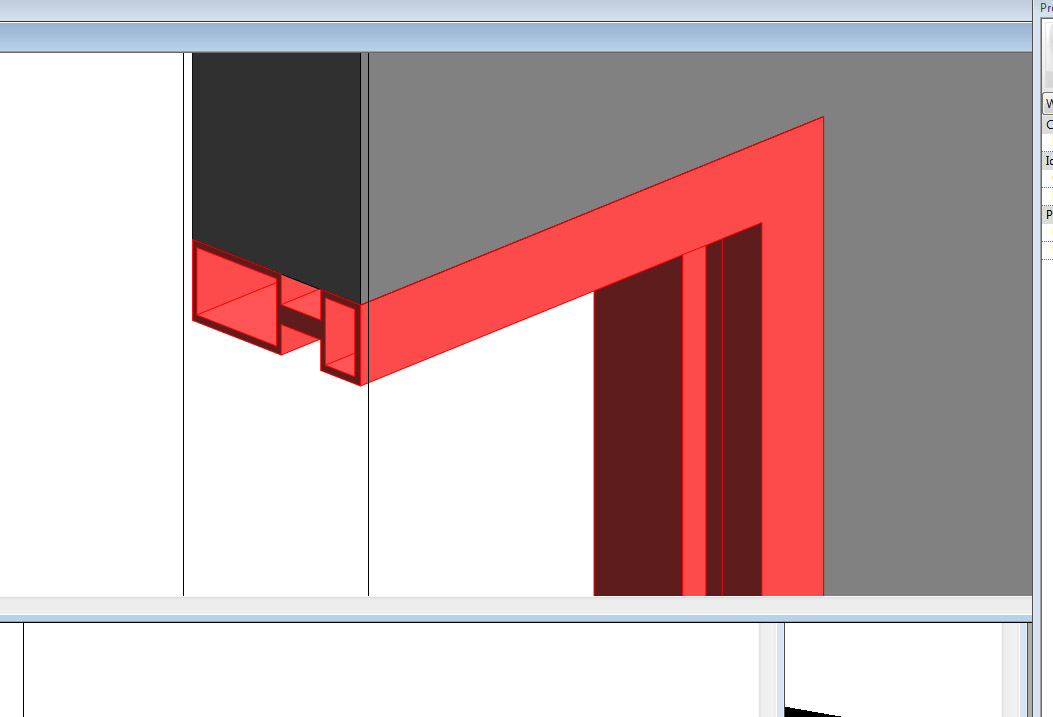

I am creating a detailed window frame as shown in the attached picture. However, I am having trouble making it sweep. Is there an easy way to do this?

I am using Revit Architecture 2011.

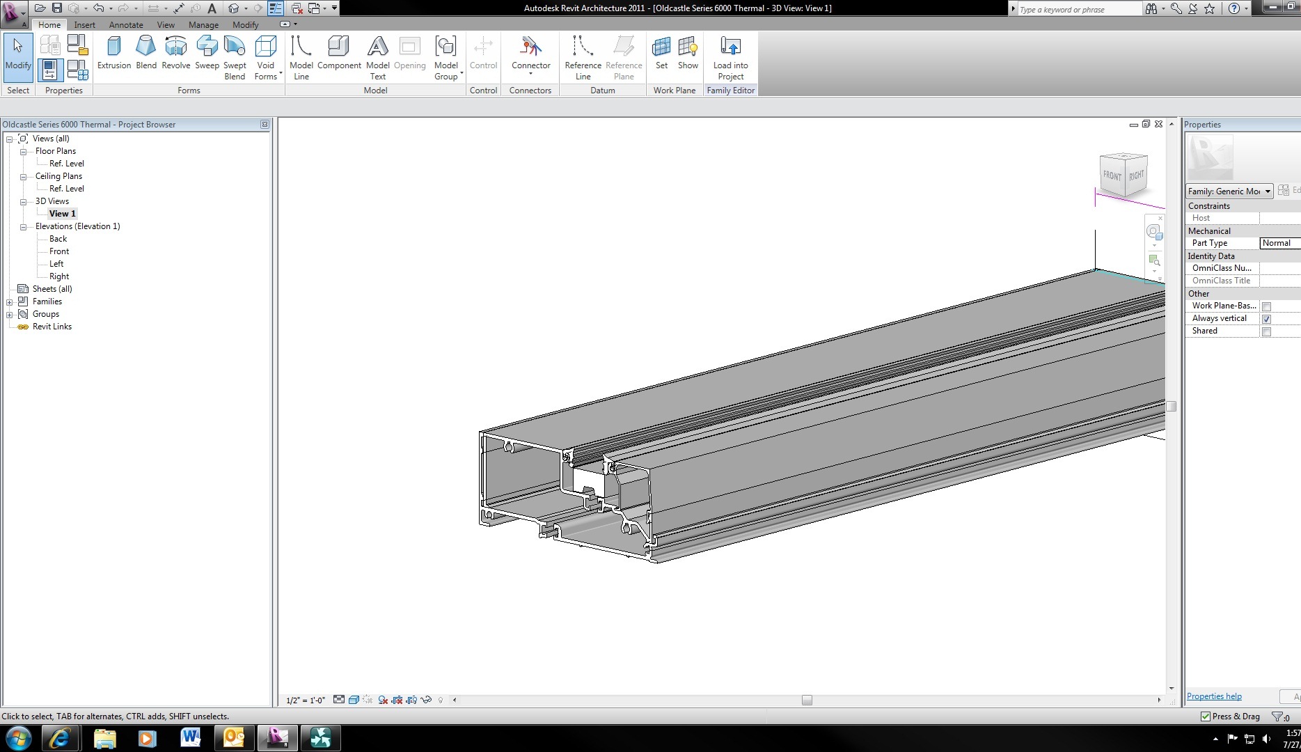

it should work fine as a sweep, you just need the profile, and a path.  What seems to be the problem?  The only problem I can imagine is if you're trying to make it wrap 360 degrees around the cut in the wall, and it's handling the 90-degree angles poorly...?
Sometimes really complex little angles and curves in your profile can have trouble navigating bends in a sweep's path.
Pic attached.  For a sweep like this,  use "pick 3D edge" for your path.

Thank you that worked perfect!
