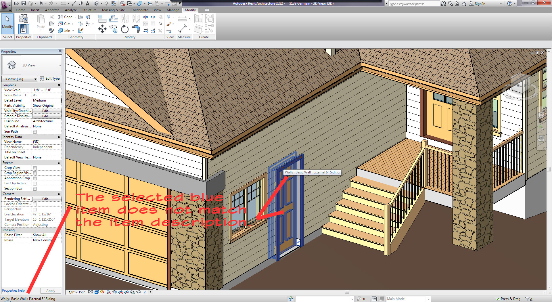

Is anyone else having issues with RAC 2012 where the highlighted object is not the one that gets selected? When I hover the mouse over an object it is highlighed blue, but when you look at the item description on the lower left corner it is a different item listed. when I select it picks up the item listed in the lower left corner rather than the highlighted item (see attached picture). I'm about to try uninstalling RAC & re-installing it to see if it's an install issue, but thought I'd see if this is common or just me?

Mine works fine, maybe you have to reinstall. RAC 2012, Vista 64

Just got off the phone with the good people at Cansel. The issue is my graphics card. I'm running an ATI Radeon, which needed an updated driver. Wow, what a difference.
