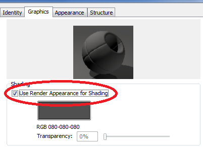

I know how to change a material through the Properties Palette, and through the Materials Settings.  But for some reason, I have occassional trouble getting some materials to change.  Here is a countertop that I have created, please help me change its material to a Black Phenolic.  I have tried changing it to ANY color...no success...
Please check my properties and let me know how I am doing with my Parameters.  Not sure exactly what and when to change these.

I didn't open the file but are you having trouble within the family its self or once its loaded into the project? If its on the project side, delete your family and Purge the project then reload the family. The material properties don't overwrite when you reload into a project. Are you talking about its appearance when Shaded or Rendered? Make sure you have the approprite settings for how you want it to display (see attached). The only other thing I can think is maybe you've used the 'paint' tool for some surfaces, that is not going to work if you want the materials to be controlled.

I am talking about both in family and in project.  I have the box checked.  I continue to have this issue with all of my families, and I do not understand what it is that I am doing, or not doing, that is causing such problems.  My realistic views are ALWAYS grey.  Even after I have changed the materials and checked the rendering appearance box.

The box you've checked is only for shaded views--what it does is gives a rough approximation of the color of the render material.  For example, if your render material is wood, your shaded view will be a warm brown, or a light yellow, depending on the wood.
Since what you see there is a default gray -- that's telling me that you don't actually have a render material associated with the material.  Go one tab over.  to "appearance" and set a .jpg to the material.
Also.  If you load in a family, and that f amily has material names that are NOT unique, IE, it's a glass countertop that's supposed to be blue frosted glass, but it's named "glass" when you load it into your project, which already has a default glass material that's transparent, your project materials overrride the family material and it'll look like a window instead of a table.
So in families, if you want to twak your materials, give them a unique name.  Like, Countertop -- blue frosted glass.
This way, they will be unique in your project, and will show up like you've set them in your family.  Also, it helps for finding the material in your material manager, because of the naming--you know what it belongs to.  Doesn't hurt to be specific, and longwinded with your material names.
Finally, if you want to change your imported family's materials, you can do that f rom your project, you don't neccesarily have to go back to your family to change the materials, and reload it into your project.

Thanks for the reply!  I have selected a .jpg.  I selected a Black polished top.  I have changed everything that I know that has always worked in the past.  This family is being VERY resistant.

I finally figured it out.  Took it back to Family Editor, and changed the phasing to New Construction, New Construction...Have no idea what that means, but it worked...
