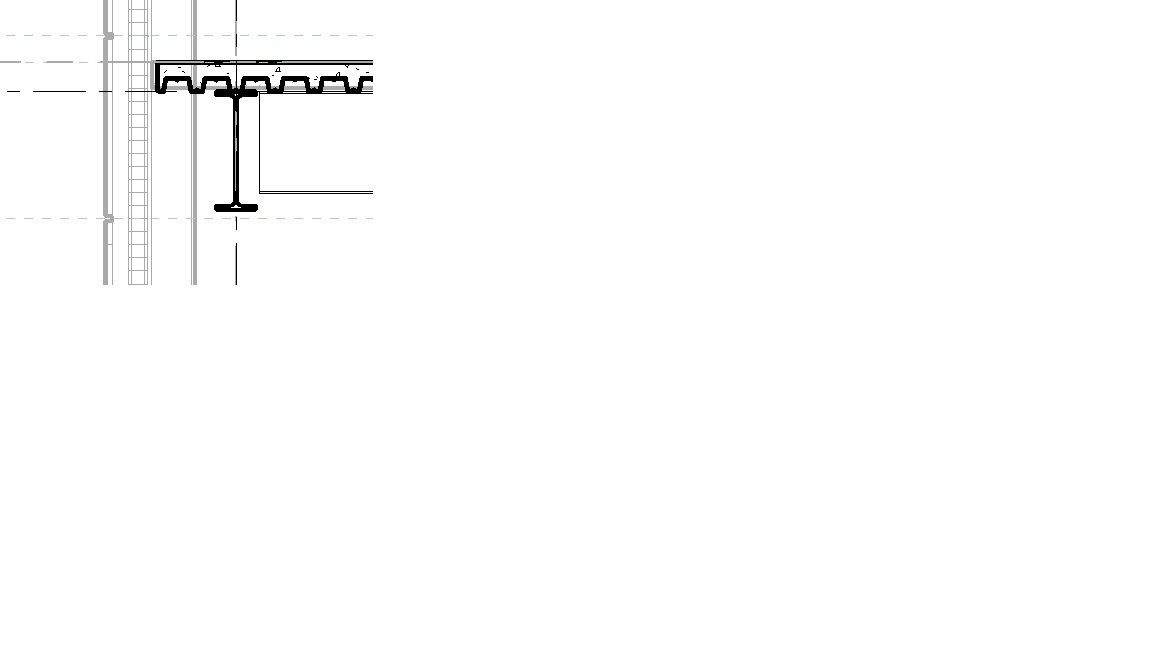

I linked Arch revit file into Revit structure. i have attched the section image. I want to hide the arch slab portion in section. I will turn off Floor in VG it will turn off arch slab and structural slab also. so how can i control view of any reference file so that in section it will display structural slab only which i have drawn in plan.
Thank you

You will want to search the help file for controlling the visibility of linked elements and how to use linked views.

VV -> Revit Links Tab -> Custom Settings -> Model Categories -> Custom from pulldown -> Floors off.
Also, if you intend to repeat this set-up say...15 times in a project, create a view template.
Make sense?
