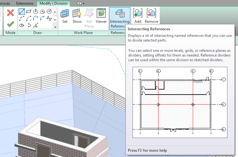

I'm taking the Revit certification test next week and to prepare I found an unofficial practice exam online from a 3rd party resource. I just want to confirm one question with the Revit community:
To divide a floor or wall into parts, you can use the following (select all that apply):
A. Lines
B. Levels
C. Grids
D. Circles
E. Arcs
The answer they are looking for is A,B,C & D. I disagree though, using arcs in sketching a division is no problem right? I would just select them all.
Tue, Jul 19, 2011 at 9:50:27 AM | Divide Parts question for Revit Certification
coreed
coreed Avatar
Joined: Fri, Feb 10, 2006
1874 Posts
4 Stars: 16 Votes
How would you divide a floor or wall in parts using Grids or Levels?
Tue, Jul 19, 2011 at 10:02:58 AM | Divide Parts question for Revit Certification
AbsoluteBIM
AbsoluteBIM Avatar
Joined: Fri, Jun 17, 2011
220 Posts
4 Stars: 4 Votes
use Intersecting Reference command. Once you hit that, a list of all your grids and levels appears and anywhere they intersect with your component, a division cut will be made.
