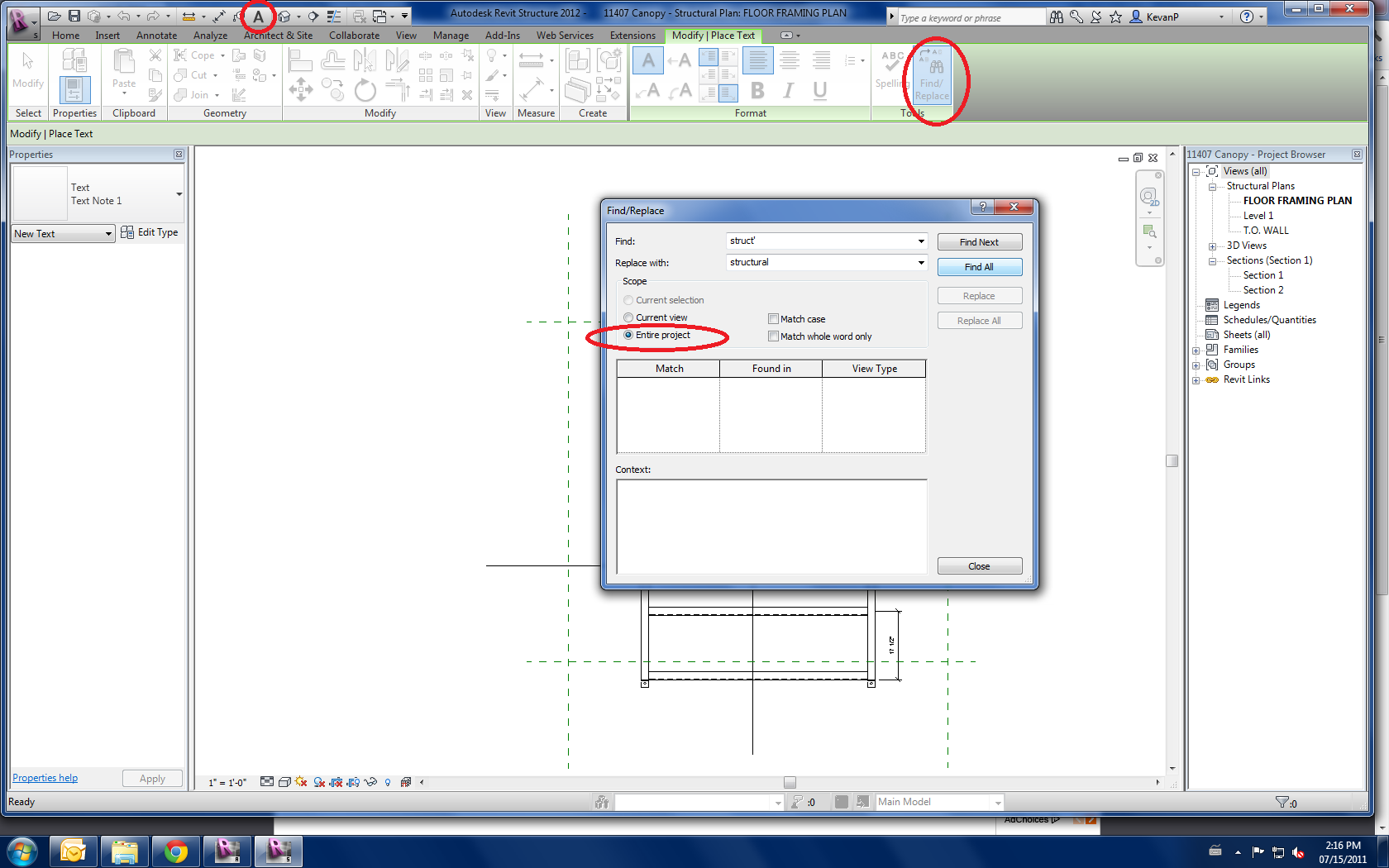

hi all..is there a way to change or revise text thoughout the entire project. e.g. struct'l to structural?

hit the big 'A' ontop to open the edit text options and use 'find and replace' as shown in the attached image.

thank you but Revit 2009 does not have the big A..where else would I find this?

I've never used 2009 but however you would normally start a text or leader command. just look up for find and replace but I can't be certain. sorry
