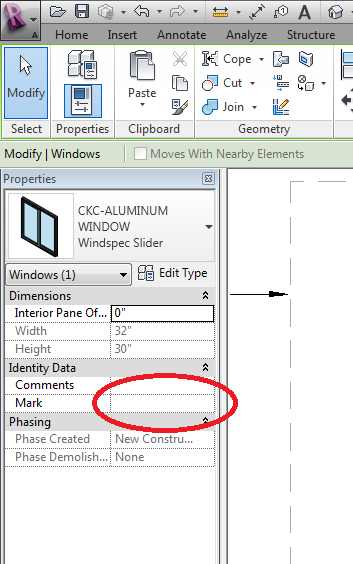

Just finished my first home in Revit 2012. A nag I have is that a typ 3'X6' window will show as say "40" and will be "40" every instance it shows in the plan. My problem is that I have to do pressure calcs on all the windows. So all the windows are different in that sense. What I would like to do is have each window be it's individual tag. Is that possible?
Fri, Jul 15, 2011 at 1:13:55 PM | Windows and Doors Individually
AbsoluteBIM
AbsoluteBIM Avatar
Joined: Fri, Jun 17, 2011
220 Posts
4 Stars: 4 Votes

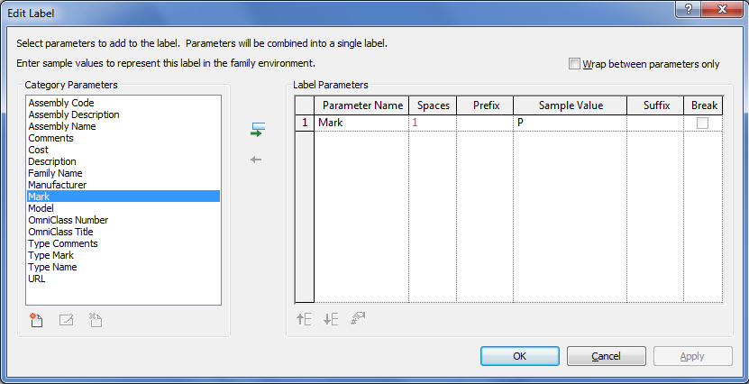

click on your window tag, hit 'edit family'. now click on the text and hit 'edit label'. I'm thinking that your tag is calling out the 'type mark', if so, remove that and add in "mark". Reload the tag family into your project. Then in your properties menu, give each window an individual Mark number.
I hope this is what you are getting at
Fri, Jul 15, 2011 at 2:24:56 PM | Windows and Doors Individually
klundin70
Joined: Tue, Oct 27, 2009
12 Posts
3 Stars: 2 Votes
Excelent!! Thank You.
