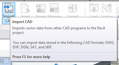

I started in Revit a little over a year ago and have slowly worked through all of our company's standard CAD details to "revitize" them. I originally just used the "Import Cad" feature to get the details in and usable and then whenever I had time, I cleaned up the linework and leaders. Now the are all done and are kept in a seperate file, in seperate views which can be easily dropped in to any project.
