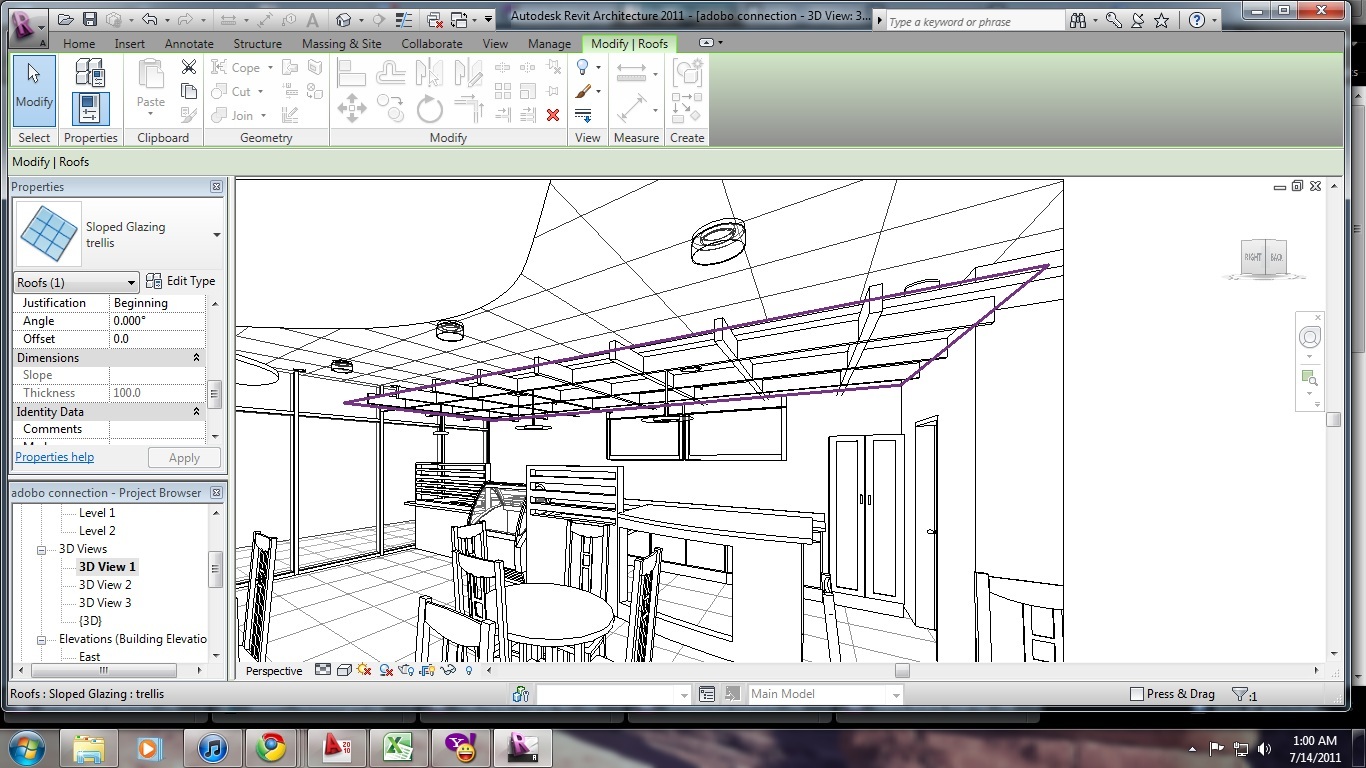

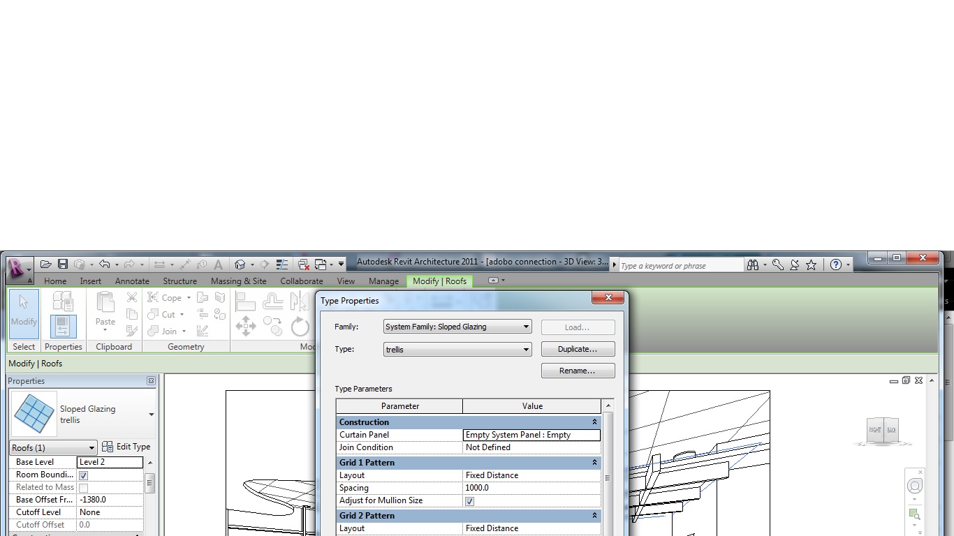

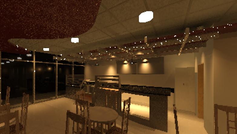

hello>> good morning to all >> id like to ask some question on this one>> its actually concerning a sloped glazing issue.. i tried to use the material as a trellis>> now earlier i did some research but now the issue is how can i change the mullion material, id like to change it to wood so that it will look more like a trellis rather than just a simple mullion frame. any possible solution to this>. because when i opened the type properties, the only thing i can see are the number of mullions, etc!! cant see any material where i can change it..pictures attached so at least you can visualise what the issue is> and nevermind the rendering, its in draft settings>> again thanks alot!!! :-)

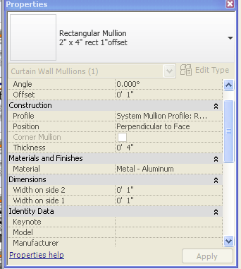

The mullion material is set in the mullion properties.  Find the mullion type in your browser and change the material there.

hmmm>> thanks a bunch>> didnt figure that out earlier>> again thanks!!! :-)
