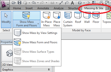

I should have included a picture, try toggling bewteen the different 'show mass' options as shown.
