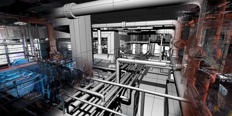

No the CAD is deffinetly in 3D.  I built it in another software package.
I am just trying to teach myself to create a Revit native model using the existing linework.
I have attached a shot of the room which I have already modeled elsewhere.
