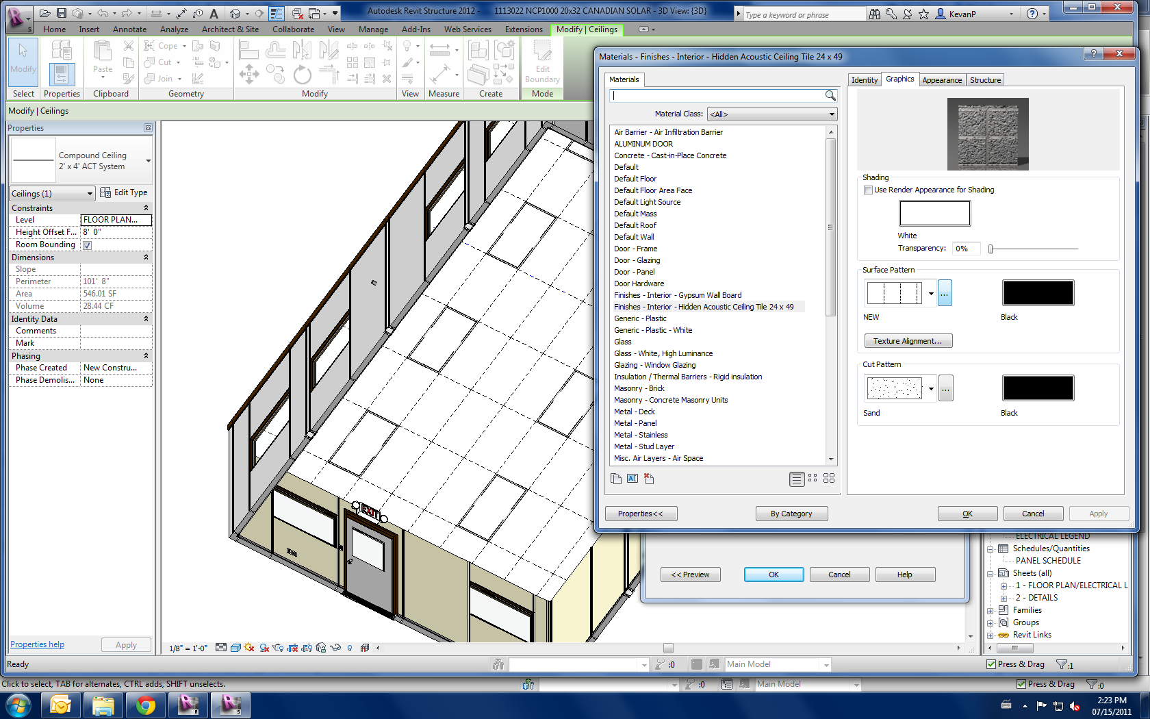

I am creating a model for clash detection, and I want to see the ceiling grid in 3D view so that when the light fixtures are installed I know they are not clashing with my grid.

we made a custom PAT file to show up as 24x48 grid for ceiling tiles (search more in this forums for creating custom hatch patterns) and use that as a surface pattern. I suppose you could also just turn on "realistic" and the grids will show up as long as you have your render appearance set up as 2x4 grid.

but how do I set render appearance as 2 x 2 in realistic view.
My current problem, is that I am making 2 x 2 ACT ceiling, the 2 x 2 pattern is shown in plan, but in view it shows 2x4 for the same ceiling.

When you assign a material, you can also assign the proper hatch.  If your 2 views do do match, then you have not assigned the right hatch for the material (or you have not picked the correct material).
