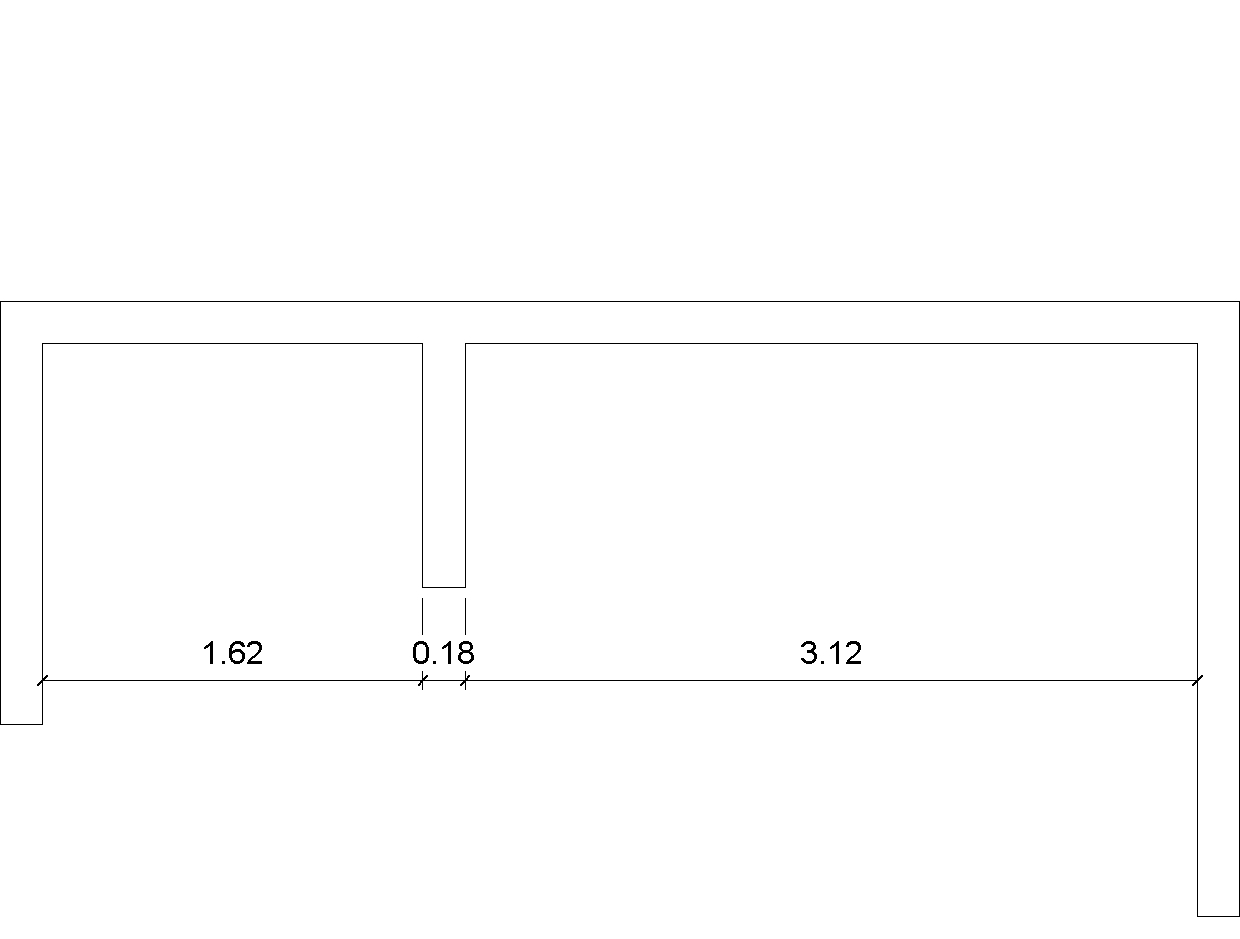

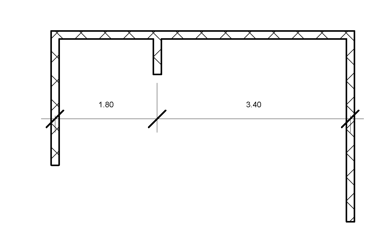

How can I set the wall dimensions to face to face instead of centerline.
See attached examples with workaround and dimensions in meters and cms.

OK, in the thread called "temporary dimensions and wall centerlines", dated from Octobre 2009, Typhoon tells Wohlfie how to work around the problem by setting the temp dim options to dimension wall faces and then convert the temporary dimension to permanent. How come you can't do it directly is a mystery until someone points out a way.
Wohlfie tries and it doesn't work for him. Maybe because it only works after you change the setting and then only when you create a new wall. And even then you still have to call up the temp dim and click on it to make it permanent.
Anyway Wwhub comes along and says: "Oh, if you just click the dim handle it will cycle through the face and centerline options.". You do however have to go to edit witness lines and add a line if you want to get the second face of the wall.
So there you are; just click on the blue handle. Not obvious, but manageable and not all that tedious.
