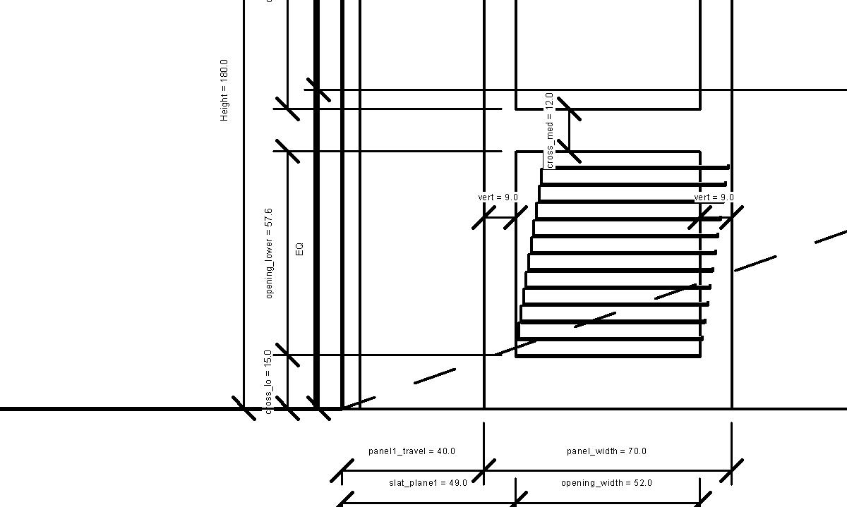

Building a family of sliding doors with louvered panels. Everything is parametric, the vertical elements of the panels, the cross elements, the proportion between the upper and lower openings. The louvres consist of an array of 45 degree slats set in the openings of the panels. Everything flexes nicely in the vertical dimension; the door height, the width of the cross elements, the number of slats adjust to opening size; so far so good. Now when you flex anything in the horizontal, that is the vertical elements, or the door width, you get a "constraints not satisfied" message and the array of slats gets staggered. I just can't find a workaround. What should I try?

Just take a brief look at your family and it seems like your door panel and the fins are not associated/locked/tied any of the reference plane.
This is not the best practice in my opinion when it comes to building families. Always set your ref planes before attempting to create your geometry/elements.
I would strongly recommend using ref. plane to constraint your geometry and assign parameters to the ref. plane other than assigning directly to the geometry.
I know some might disagree with me, but I would never do it that way. Also, use create the fin as a nested family and use it for the array in your panel. I had so much trouble in the past not using it as nested family. Even I got an warning in the past (from the family editor) that suggested using nested family for any array.

OK, I did the tutorial, defined the reference planes, set the origin, locked the dimensions (in most cases), binded the planes and linked the parameters from the loaded family to the host family. Still no cigar. When I flex the single louvre, it adapts just fine. When I create an array, it still skews off to the side when I change either the door width, the jamb width, or the opening width. Everything else flexes properly. Can you please point out what I am still doing wrong?

I still think your family has a number of issues.
first, I would add a ref plane to the center line of the door panel so that it can be used to lock the center of the slat.
(you didn't lock the slat for the first and last one, therefore, it is shifting to the side)
You also didn't set the height for the first slat to be constrained so it will be a problem later.
My suggestion is to rebuild the entire door panel with the louver as a nested family (meaning to have a slat nested to the panel and the panel nested to the host "wall") then you will be better off to control the behavior of the entire panel.
It will take your time again but I am sure it will be worthwhile.

Two things are for sure:
1:  Coreed's suggeted tutorial by Mr Spot is really, really very helpful. Thank you.
2:  Pchan's tip of locking the upper element of the array onto the reference plane solves the skewing problem. Duh.
Also doing the tutorial (as Pchan insists I should) and creating nested families (even double nested in this case) is going to solve a whole bunch of issues I didn't even know I had. Thank you also.

Here we go. Attached is a fully parametric louvered window. This one flexes nicely in all directions.
As Pchan and Coreed's tutorial pointed out, the answer is to make sure you anchor the last element of the array to the reference plane as well as the first element. Also, repeated nesting of components prevents a whole slew of problems.
