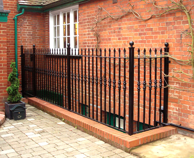

Would anyone out there be able to advise on the best way of creating railings as per the aattached image?
Particularly the spherical details and arrow-shaped details?
Thanks

You can make new, custom baluster families.  You should have a template for the baluster family, and with a couple sweeps/extrusions/revolves/blends, you could model those pretty quickly and accurately.  Then, load them into your project, and make a new railing type which incorporate your new balusters.
