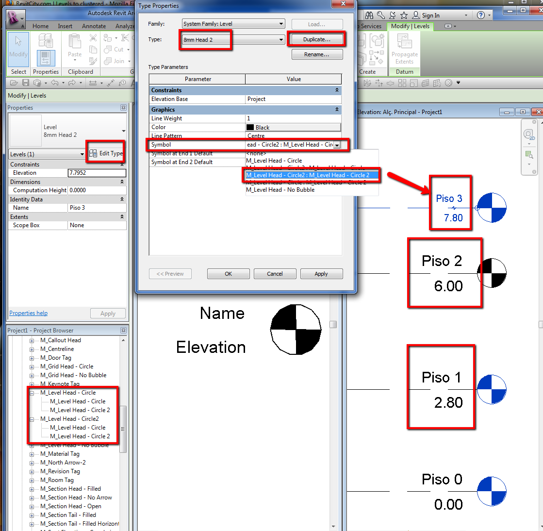

Is there a way to clean up and move the text on levels freely and also can we make it smaller? I duplicated it and there is no option to change size.
I want to keep the indicators inline but move the text.
Thanks.
http://screencast.com/t/pkGpfCXJQX
Fri, Jul 1, 2011 at 2:29:33 PM | Levels to clustered
Levels tags are a family tag that you can edit and that would be the way you change the location of elements in the tag.  To have different locations at each tag, you would need different tags.

http://screencast.com/t/Q3RCNtZdbr0
Thank you for the response.
What to change? There is no text size or different family tag. Please clarify

You will need to edit that family, duplicate and change what you need then save with other name, load into project and then you can have differents levels tag like you want.
