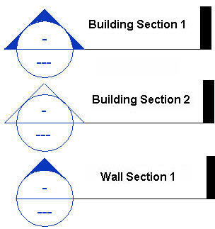

So I am using Revit 2012, and maybe I am missing something that is right in front of my face, but...
I am trying to Duplicate the "Building Section" system family type and create a "Wall Section" with a 1-point arrow head instead of the 3-point arrow head that is on the Building Section.
Seems straight forward, but when I change the head, it changes it for both the "Wall Section" type that I created and the default "Building Section" type.
Any ideas as to what I am missing here?

You are on the right track and it's lengthy to spell out in words.
Have a look at this blog post and video on REVIT Section Bubble Heads.
http://revitrocks.blogspot.com/2011/06/revit-section-head-bubble-cadclip.html
