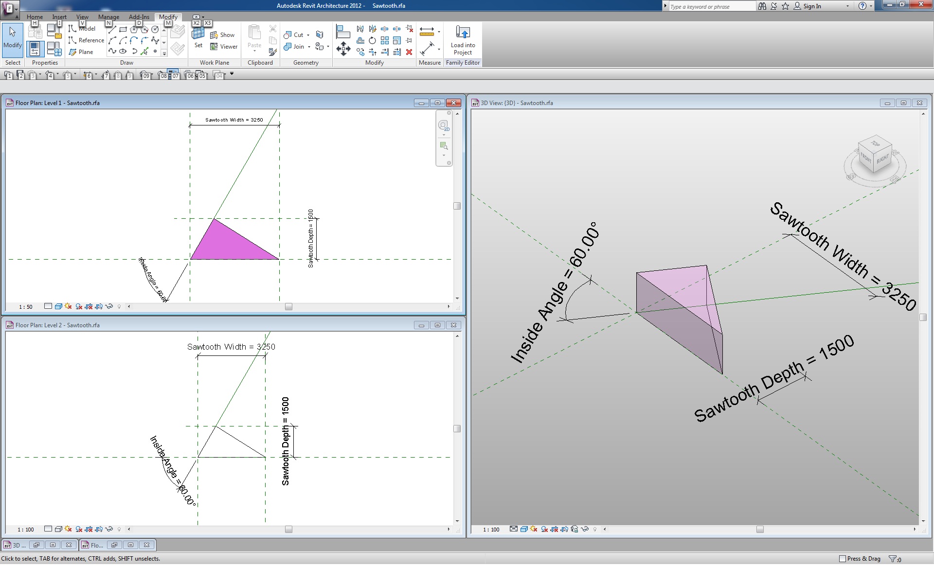

Im stuck.. i need to mass out a sawtooth mass that will have the ability to change the inside angle. i can do it in plan but when i create the 3d mass, i can't seem to adjust the angle without removing constraints. please help.. in a time crunch and i cant figure this out.  seems like it should be pretty simple but im drawing a blank

Here you have, check the family and you will see the differences.
