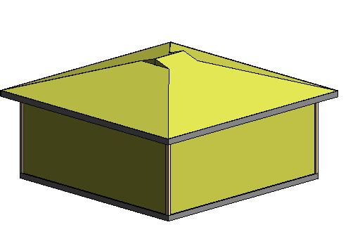

Hi Guys,
Im using REVIT ARCHITECTURE 2012 and just cannot figue out how to draw a chamfered timber plinth around my suspended timber floor deck. Do i go into profiles and modify the family or is there another way? I have tried modifying the family but when i import it it is only in 2d and there is no extruded bits. Hopefully im overcomplicating things and there is a simples way of doing it.
I have attached the Plinth detail and the building where i want to connect it to the floor deck.
Thanks for your help

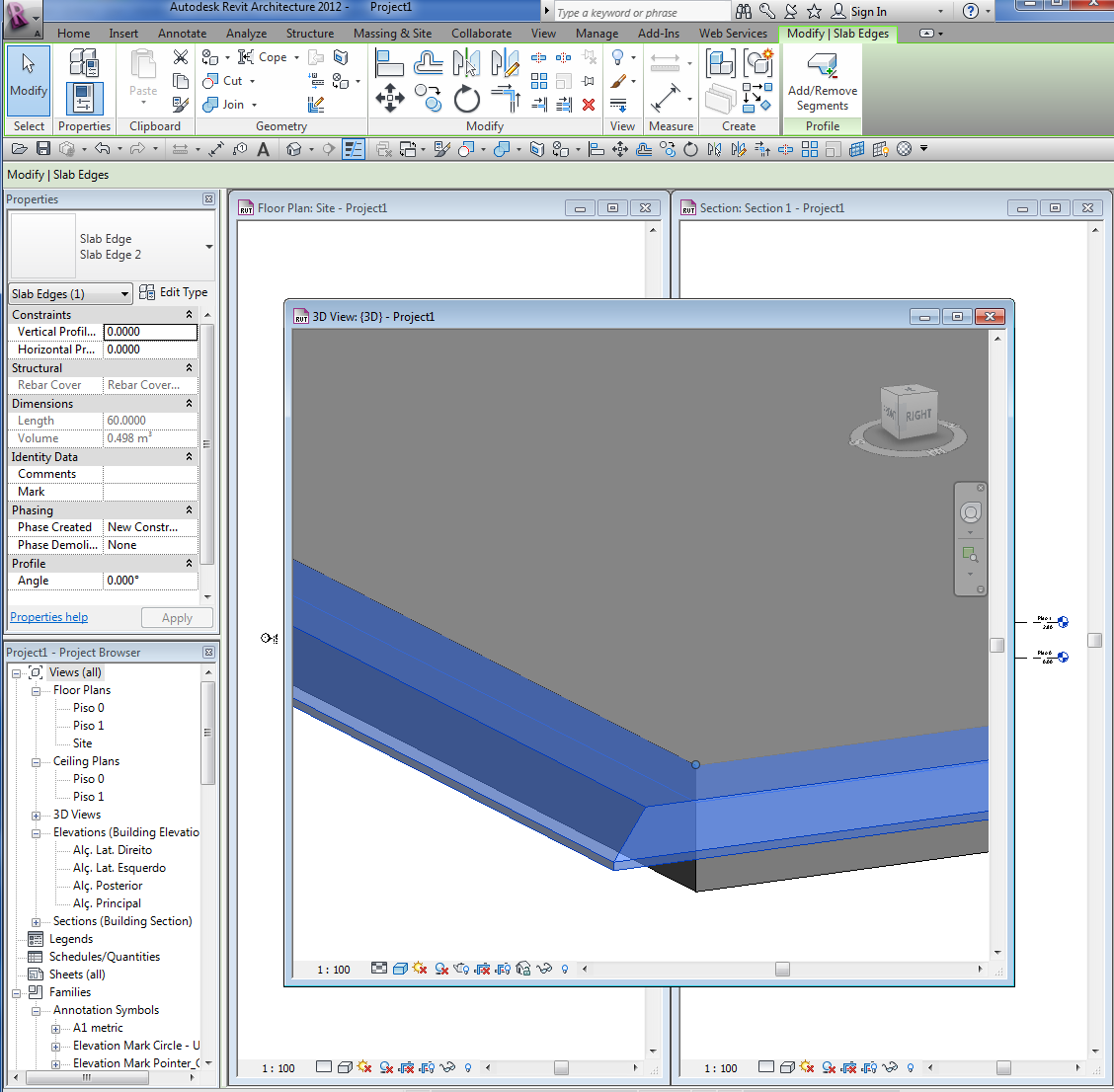

Just create a new profile and use the "Slab Edge" tool

Muinto obrigado amigo!!!
Funcionou.
It worked, sorry i assumed you were portuguese as the screenshot you used was in Portuguese!!
