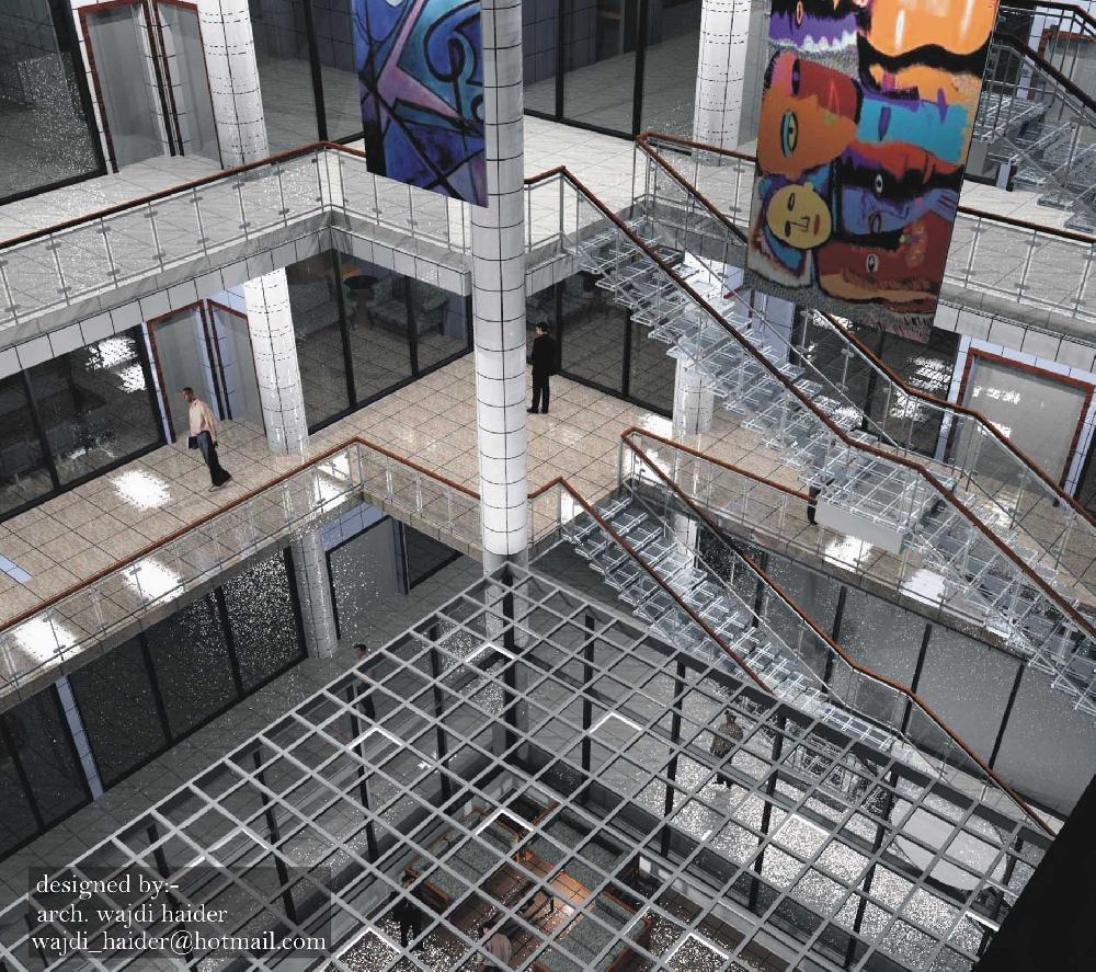

i would like to know how can i do a railing using just glass panel on interior of a railing?!i have tried to load the file " M_Baluster Panel - Glass.rfa" but is doesn´t work very fine because i always have there the other baluster that i don´t want to be there.so a realy just want it with glass on interior and exterior can be normal. tanks. Ruben Vieira this picture shows a good exemple of what i want to do

You should be able to Edit the baluster panel family and delete the end baluster and align the glass edge to the dimensioned reference plane. Then in the railing baluster properties set up the baluster panel spacing to where the panels butt to each other.

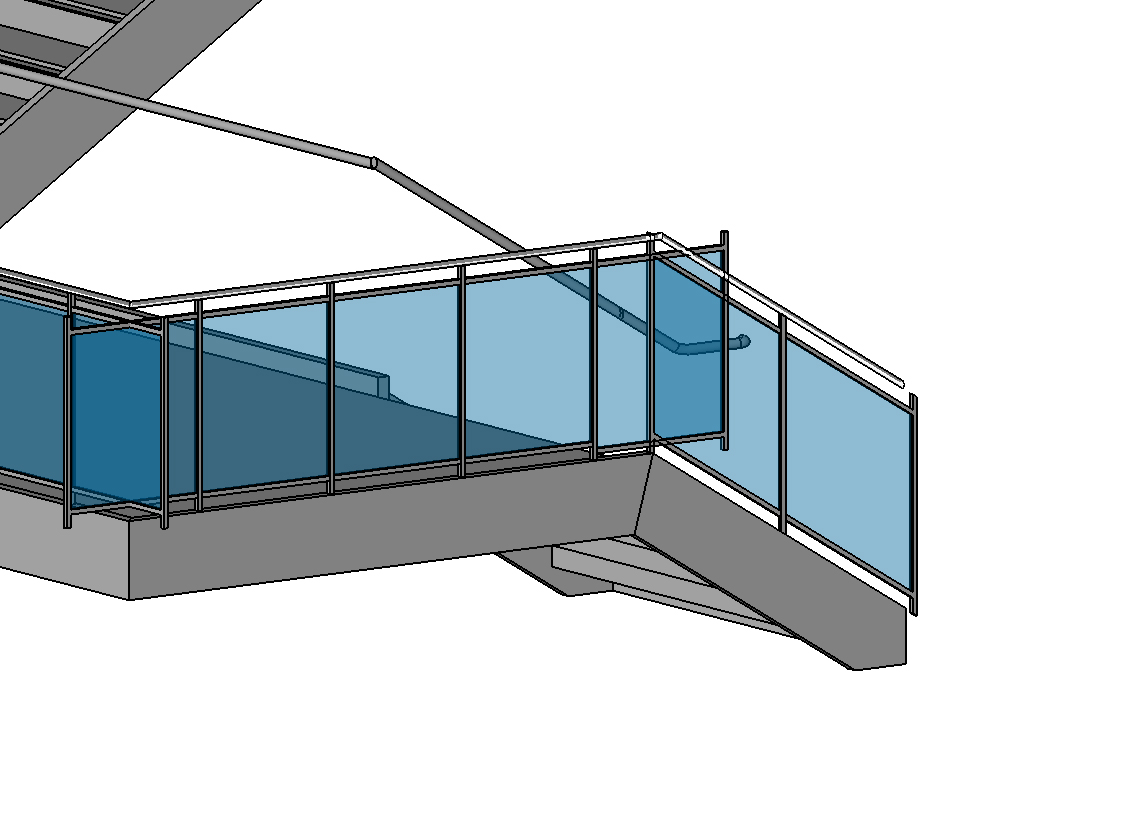

thanks for all of the help- but unless there is a way to interupt rails, this solution isn't what I'm after.
 the solution in the tutorial creates a swept plane of glass that starts at the top of the stair and ends at the bottom.  if I was interested in creating a system that is created of panels that are interrupted through out the stair, then this wouldn't be the solution.
 in the photo orv posted, there's an interuption to the sweep halfway down the stairs (2 panels).  any ideas on how I could do this with out the result I found?
