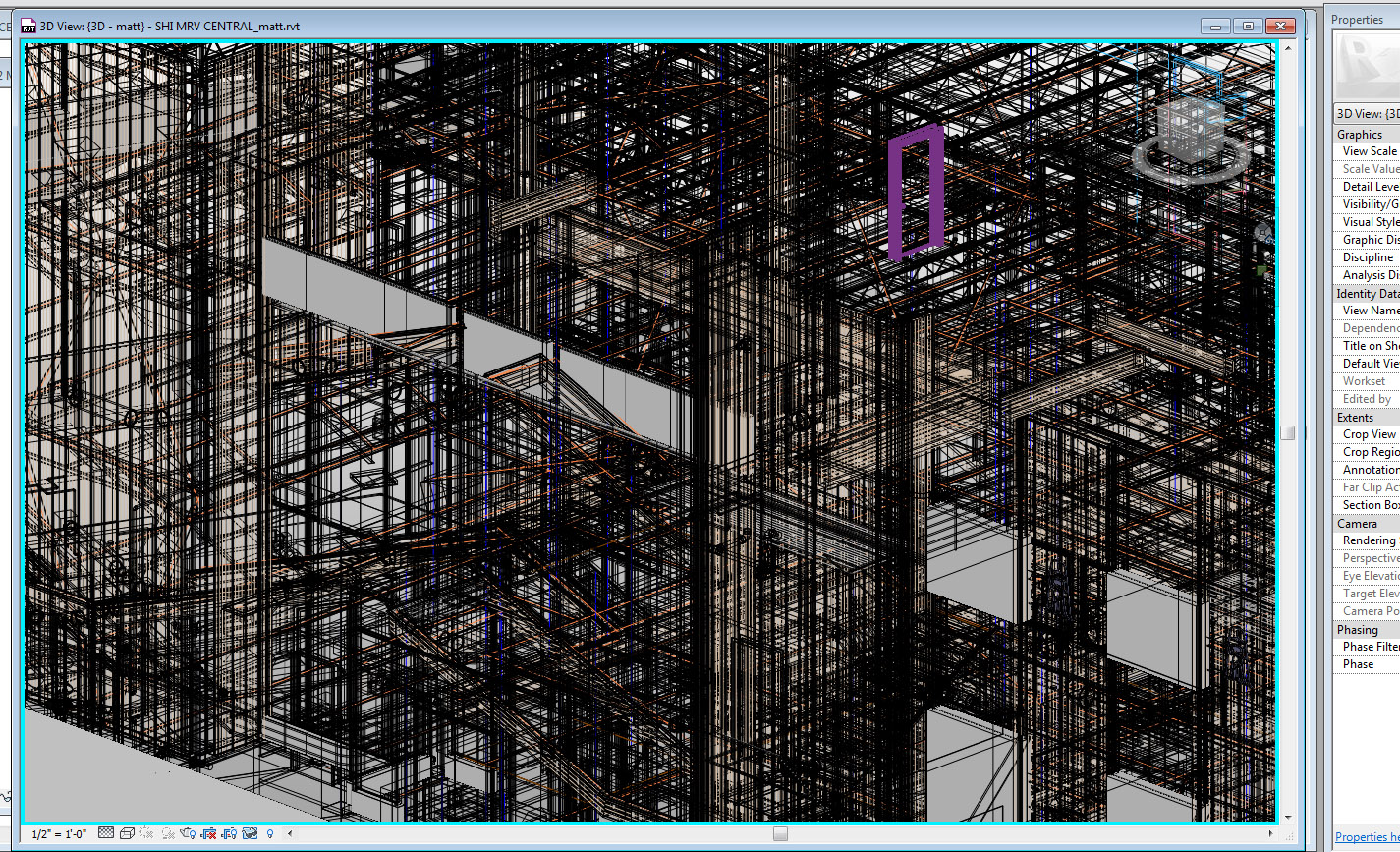

Attached is an isometric wireframe view of one of my projects nearing 50%, with consultant models linked in too.  See how many -lines- revit has drawn?  Compare this to CAD.  It looks like a mess, but the BIM aspect of Revit is the ability to categorize and control these objects/lines in a sensible manner, to be used selectively in any type of view--details, sections, elevations and plans, and it saves so much time in the end.
