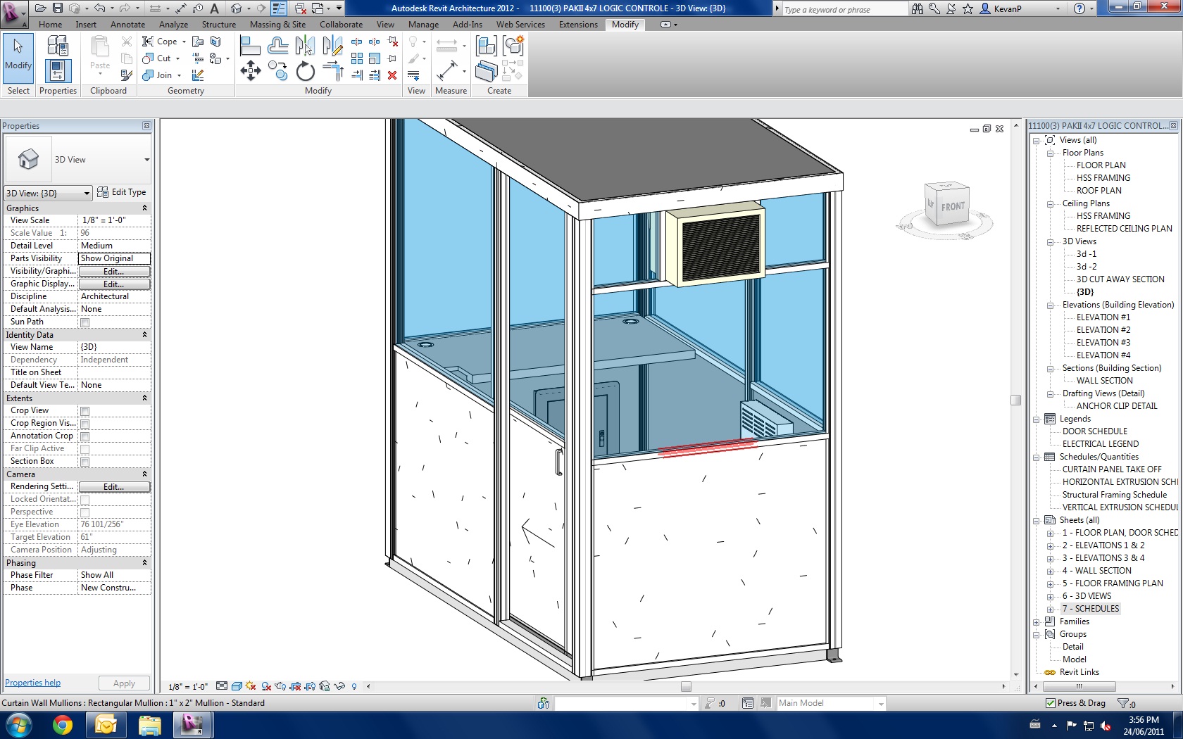

For all my projects, I provide a schedule of all the horizontal and vertical extrusions (mullions). For this project, I have to provide an opening for an A/C unit so I added some curtain grids. Now the horizontal mullion below cuts into three pieces and schedules as three pieces. Is there a way to force them to ignore the grid cuts above?

You can do that in other way, edit that curtain wall before you insert mullions, then create the horizontal grid lines, now insert the mullions

Great idea, worked perfectly. Thanks!
