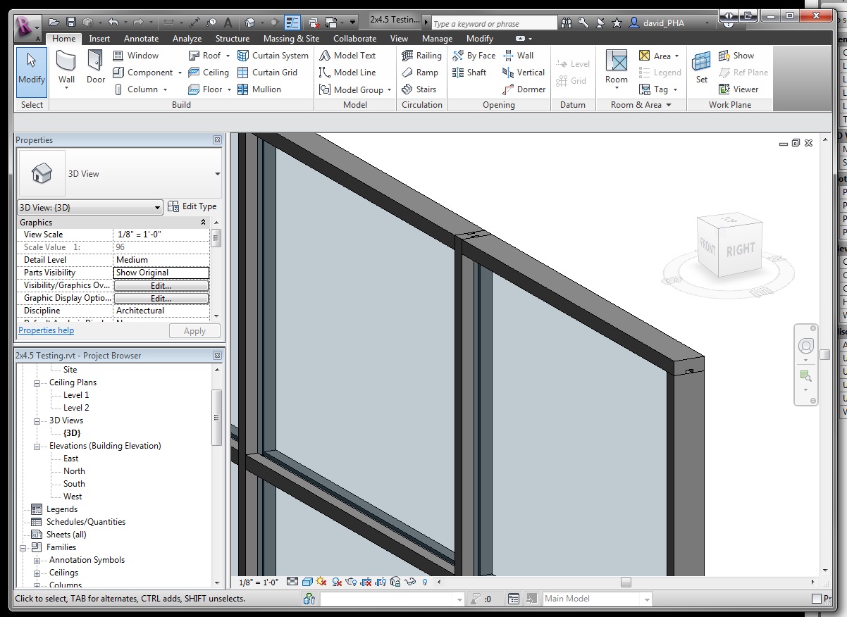

Hi all, Please see the attached pic. I'm trying to become more familiar with Curtain Walls, and I wanted to make my own 2 x 4 1/2" aluminum profile.
From my understanding to achieve this I made three families, each a profile or the left-bottom, top-right, and center profiles of the mullion.
I imported the profiles, made new types for these profiles and assigned them to the Curtain Wall I created.
It looks good except for the corners and points where the mullion intersects with the outside edges.
Can someone help me? From the way it appears with the default Mullion family, I should only have one family for my Custom Mullion, but not sure how to achieve this.Thanks!
