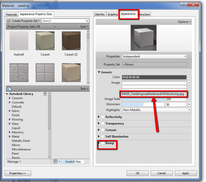

Hey guys anyone have a good weatherboard cladding they can share and also how to apply it? Thanks heaps.

Thanks heaps mate. I think your idea for painting would be better as if I edit the wall even the internal walls will change to weatherboard. Next problem is how do I add your jpeg as a material I looked in help and all I found was something about the identity tab in materials but didnt help. Thanks again for your help much appreciated.

Like "Aspect" said, "you can substitute in the 'Appearance' settings of the wall material", duplicate a new material and in "Appearance" you can import that jpg

I got to that stage but couldnt add it as a new material...wouldnt let me rename it or anything

Yeah thats what I have done although when I duplicate the view and then put Horizontal 150mm as surface pattern but then it doesnt show once rendered
http://screencast.com/t/pKBaSqcgUJ
I'm guessing I need to add the material in there ( jepg ) not sure if thats right or how to do it
http://screencast.com/t/HsDGC3AGj
no option here to add it
Thanks for you help I difinatly wont want to make revit harder to for than it is haha

Surface patterns don't render -- they're just for unrendered views.  They're also used as a reference for the direction of your render material.  You can rotate a hatch, and it'll rotate the render material, for example.
You DO need to load in a JPG.  You can have two, for your materials.  One, the material, and the second being a Bump file.  The bump could be lines, if you want, or you could just have one jpg with your cladding, lines and all, for simplicity.  Typhoon's pic is pretty clear on how to replace the image path for a material.   Check through the existing materials for siding though.  You can also resize the scale at which materials tile.

what I typically do is open the folder where materials are stored (autodesk/common files/ shared.../materials 2012/mat 3....this may not be the exact path but it should help)  and find the jpeg I want to use.
Then I open that file in photoshop and give it a color that I want, then save that new jpeg in MY materials library - not the autodesk one.
Back in Revit, manage>materials>duplicate a similar material>rename  then change the appearance by picking the jpeg and replacing with the one you just made from your library.
I have had very little luck with assigning color to a jpeg for rendering purposes.  it works much better to do it in photoshop.  This seems like a pain the first few times, but does get easier.  Also, when rendering I usually make the material darker (especially painted items) because the color tends to wash out a lot in Revit renderings.  It will really help if you have a color card/wheel with you.
hope this helps.

Thanks heaps for your help guys when I duplicate it in typhoons pic its simple to add a image... although mine look like this
