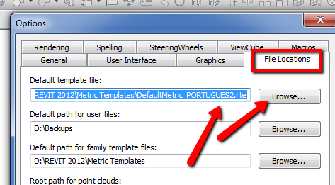

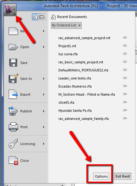

Here: the big "R" then "Options"

Ohhh, cool hidden button.
