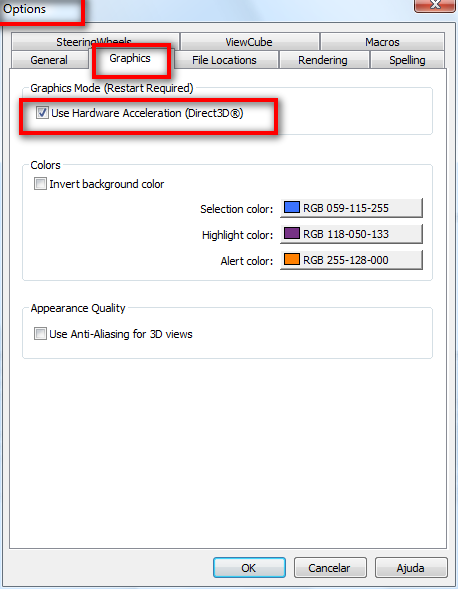

One question, did you turn ON the "OpenGL or Direct3d" in your "Home Revit"?

I cannot reccomend enabling openGL.  On our computers it was constantly messing with the depth clipping.  I don't know how or why.  panning and zooming for a short time in an elevation view would enable "clipping without line."
