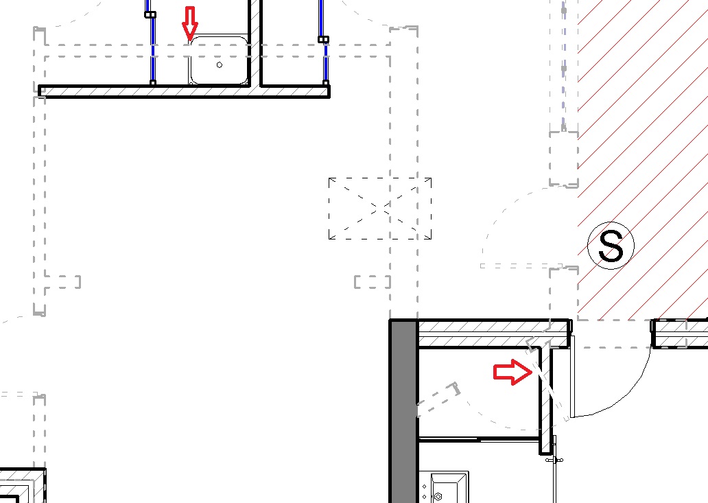

Hi guys, I've been trying to fix this problem with no success at all. No idea what I should do by now...

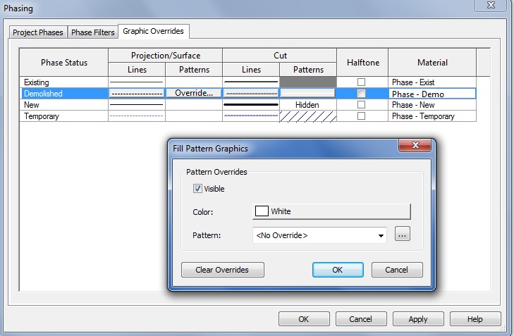

Check the picture so you can understand what I'm talking about. You can see two red arrows pointing at the problem. My walls and doors to be demolished are hiding the proposed objects and even the proposed walls. I tried overriding the demolish by going at the phases dialog but it didn't work. Would you be able to help me on this?

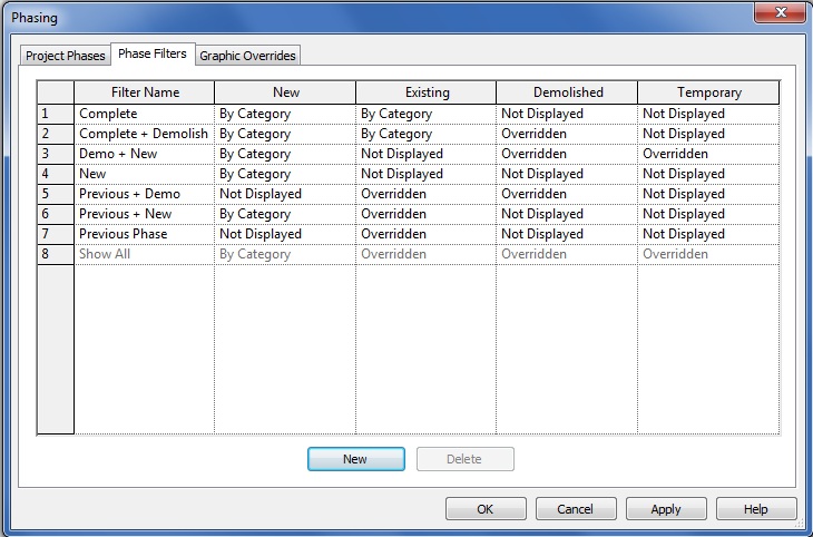

Phases will work so try again.  Maybe come back with your view settings and your phase settings.

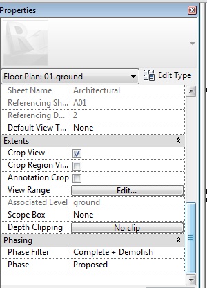

There you go.   :-)

So you have set your view to the appropriate phase?

I did. Phase Filter "Complete + Demolish"...
