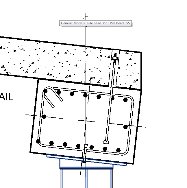

I have a slopped slab that has been slopped using height off sets on the slope arrow ends. The slab has been automatically plumb cut. How do I make it a square end?
Mon, Jun 20, 2011 at 7:21:17 AM | How to not plumb cut a graded slab
You might try a slab edge.  Not sure if that is affected by slab slope.
If the above doesn't work, you can extend your slab past this point and add an in-place void family.

if its just for this detail I recommend to use the "CUT PROFILE" under view tab. thats what we use
