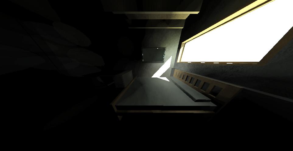

As the topic describes i am trying to put a ceiling fan on the ceiling but when i select the ceiling fan component it shows the circle with the line crossed on it... meaning it wont let me put it there.... thanks.

That's because that family was not created to attach to a ceiling, that's why you have that "Circle with the line crossed on it..."

ahh ok thanks, so is there anyway to attach the fan to the ceiling or is their another method?

Create a new family, in this case a "Generic model ceiling based" then Copy/past from the "Original" family to the new family and attach that object to the ceiling with the "Align" tool, if that family is a parametric family you will loose some parameters but....

what CAN your ceiling fan attach to?  You also might check the library for a "face based" ceiling fan.  Be sure to read the details of what you grab.

ok thanks =) and just one last nubbie question.. when i render an image of inside my room i cant get the room to be fully lit so i can see everything within it.I have tried different schemes but i just cant seem to get the image of the room fully lit up? I have included a picture to demonstrate please help thanks.

You need to turn ON the "Daylight portal", search in your HELP menu for that
