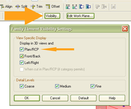

Open the family. Switch to 3D view. select each of the elements. Click the visbility button. (refer image) Check its on in plan.
