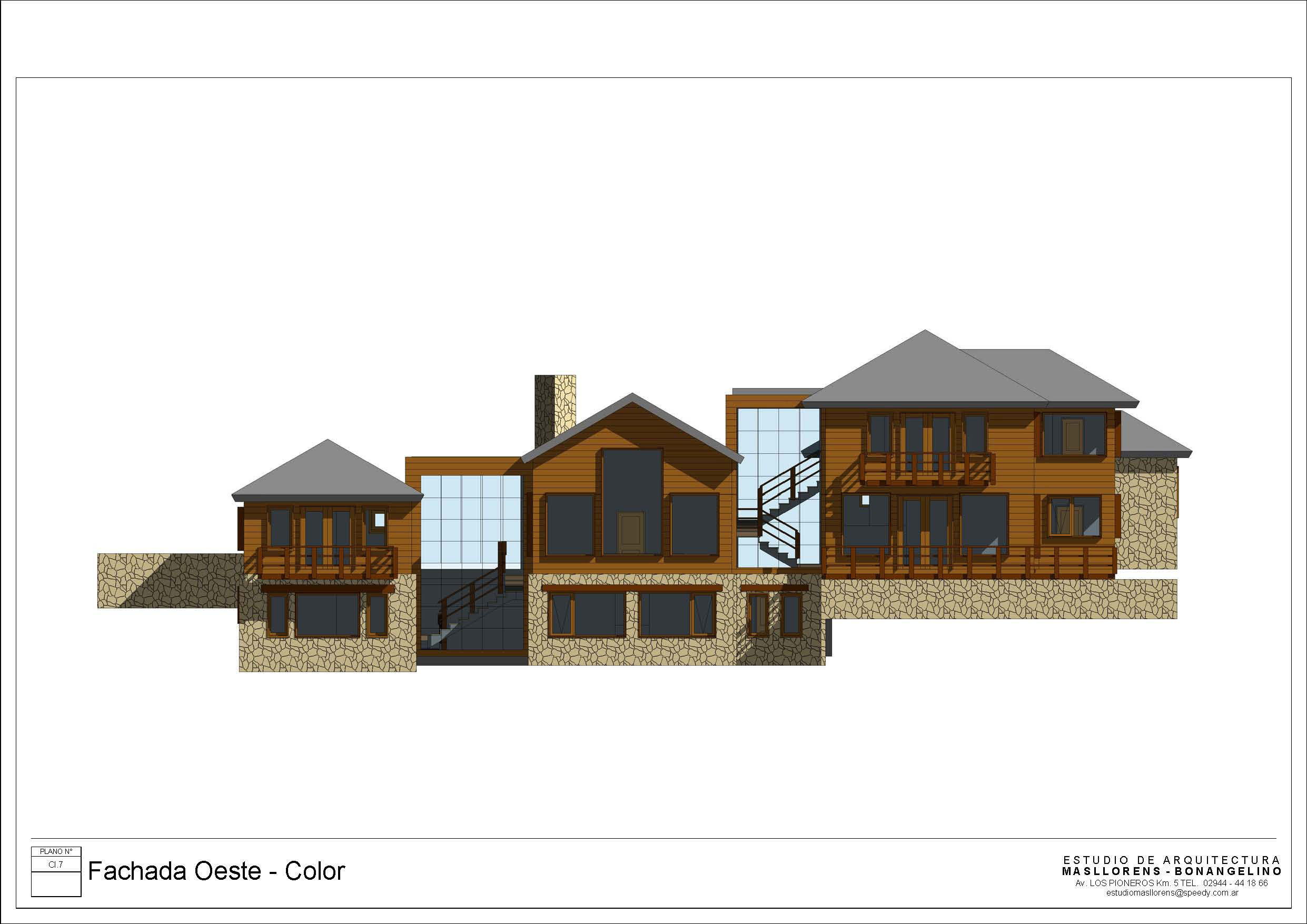

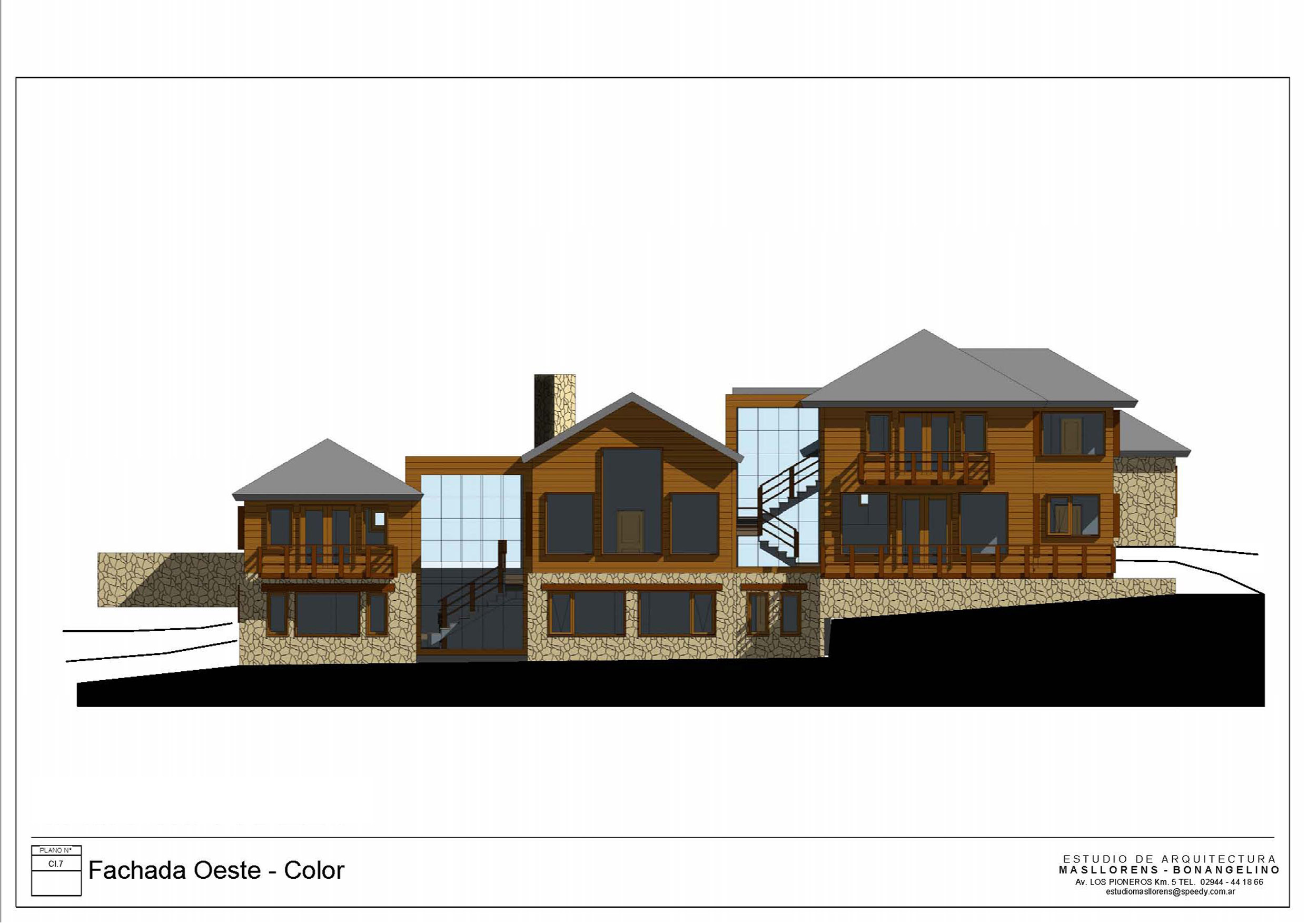

Luquex
Joined: Wed, Jul 15, 2009
7 Posts
Thanks!
Yes, you are Wright,  for the moment I solve the problem using the Design Review:
I attach two JPG:
01-Problem
02-Solution
I think that Revit must have the Alternative to make the "region mask" in the Sheet....
Working with the Desing Review was Easy, but, now I have an "extra" file....

Fri, Jun 17, 2011 at 6:44:55 PM | Masking Region in 3d views that´s Aligned to an Elevation View
itsmyalterego
itsmyalterego Avatar
Joined: Thu, May 28, 2009
829 Posts
4 Stars: 16 Votes
Well, here's my suggestion then.  Put two views on your cover sheet.  One being your 3D view, the other being a drafting view.  You can then activate your drafting view, and draw lines/regions over the top of your 3d view.  Pin your views in place so they can't move.
Pic attached.
Sat, Jun 18, 2011 at 8:40:04 AM | Masking Region in 3d views that´s Aligned to an Elevation View
Luquex
7 Posts
Thank´s, The last suggestion Work´s Perfectly!
