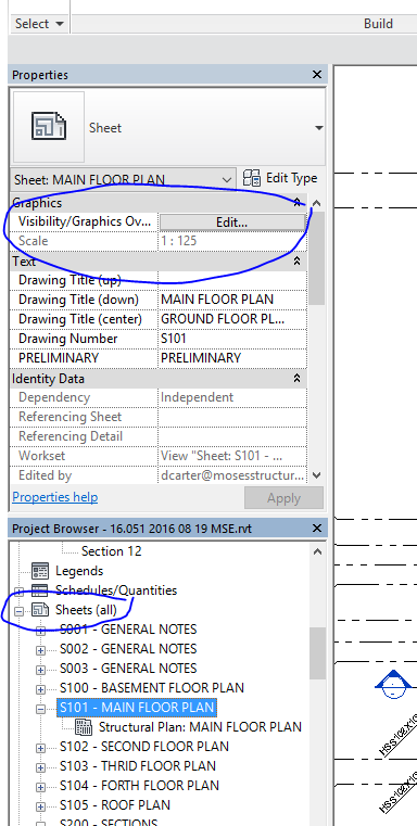

Is not text. My floor is set to scale 1:200, when I go to my sheets which includes the title block I click on the main floor plan (where I have the problem) and I click on it. Properties in the sheet: Main floor plan show a scale of 1:125 and I want 1:200. and this is why it shows on the title. but I cannot modify it since is in gray non editable.

Sat, Aug 27, 2016 at 7:42:35 AM | Help, Title block scale appear to be wrong and can not be changed
You do not say - is this the only view on the sheet?
Some things you sayt are confusing.   You write "...when I go to my sheets which includes the title block.."  hugh?   I your titleblock sepereate from the sheet?   The titleblock should be part of the sheet family, nhot something added to a sheet.

Please see attched pic, and I as was saying the scale I cannot modify it. The floor plan is set to 1:200 but idk why is still saying is 1:125
