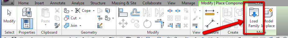

I want to place a component in 2011. where do you choose what component you want?
click the component button, then what, where is the list of components to choose from.???
Mon, Jun 13, 2011 at 1:47:39 PM | revit 2011 noob menus
Joined: Tue, May 22, 2007
5921 Posts
4 Stars: 205 Votes
Here .... "Load Family"

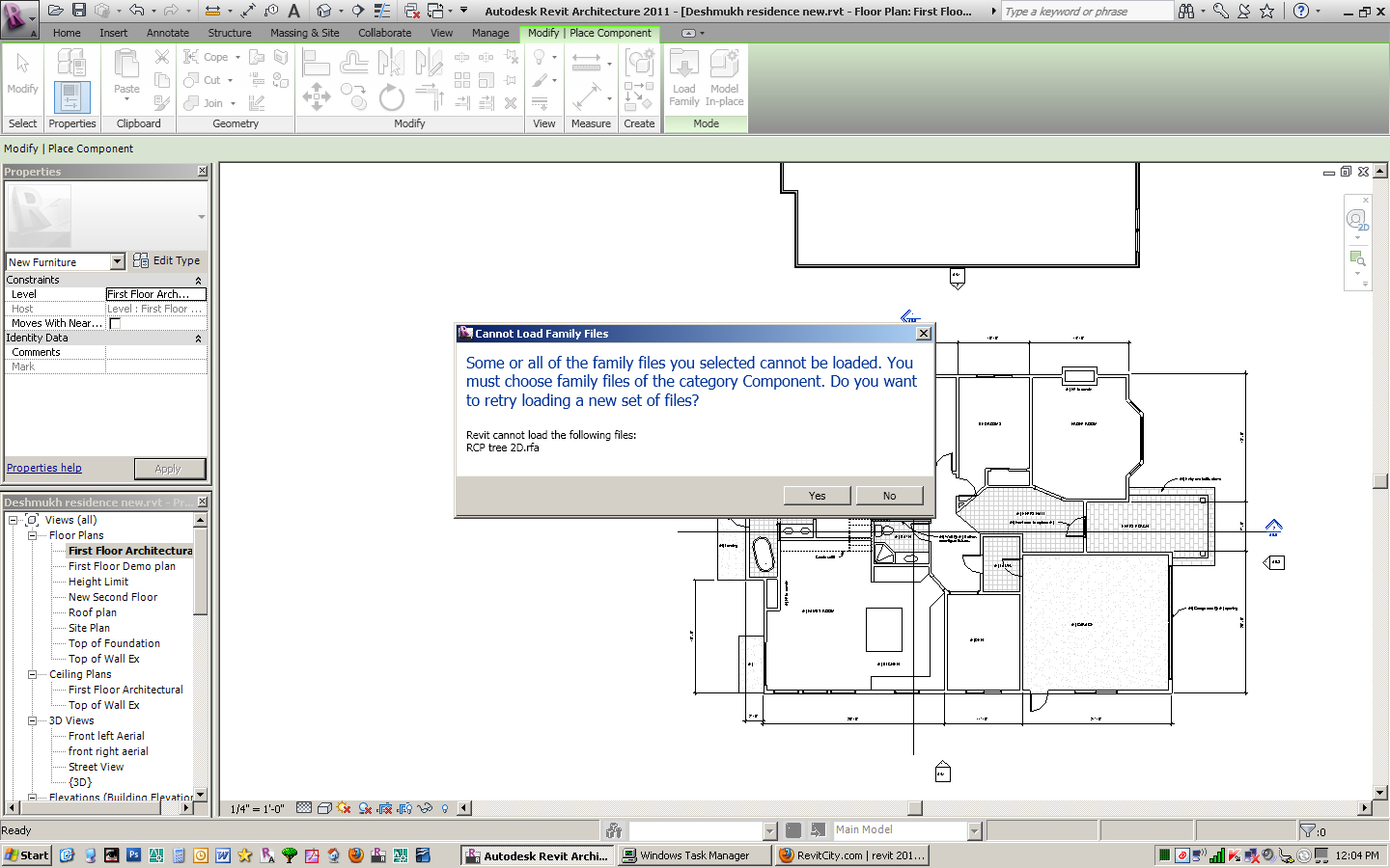

Thanks for that last post. seems weird that the menu now is only in the prop window. no little drop down....all the buttons and crap are really big, take up alot of area of the screen now..
but what about this: I try to load a tree (its a 2d plan thing only) and I get this error message (see screen shot)
Mon, Jun 13, 2011 at 2:20:35 PM | revit 2011 noob menus
That error message is because you are not in the correct view to use the item.
Mon, Jun 13, 2011 at 2:35:18 PM | revit 2011 noob menus
Warchitect
Joined: Wed, Aug 20, 2008
318 Posts
4 Stars: 5 Votes
so how do I find out what it is?
its a tree...2d plan thing....so its an anootation then? what? why is that stopping me from loading items into my project?
previous versions lets you load whatever whenever...
Mon, Jun 13, 2011 at 5:24:44 PM | revit 2011 noob menus
pchan
pchan Avatar
Joined: Wed, Mar 5, 2008
208 Posts
5 Stars: 5 Votes
For plants, you should be able to load the families from the library by going to component or site component (under massing and site tab), then choose load families.
The reason you can't load/insert the family (i.e. your screen) is you are on RCP view.
go to any of the floor plan or site plan and try again.
