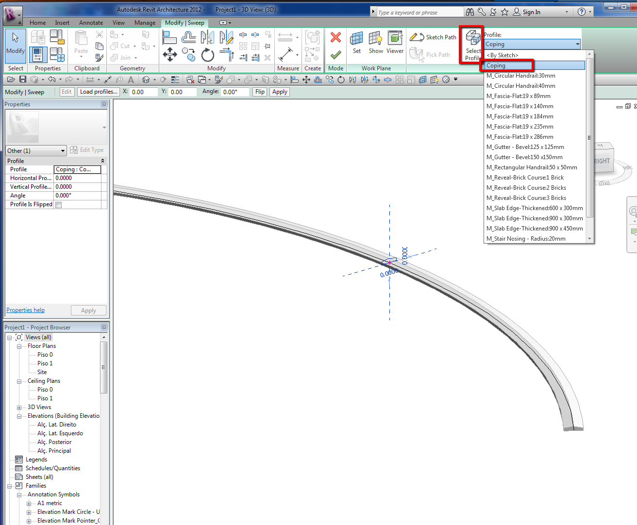

I cannot load a profile family for a wall sweep.  First there is no  to load  a new family  while in the properties.  I tried loading the family while in 'place a component'  and' model in place'.  The first gives me the message 'cannot load, must choose family of the same category'.  The second loads the family, but it does not show up when i try to change the profile in the wall sweep.

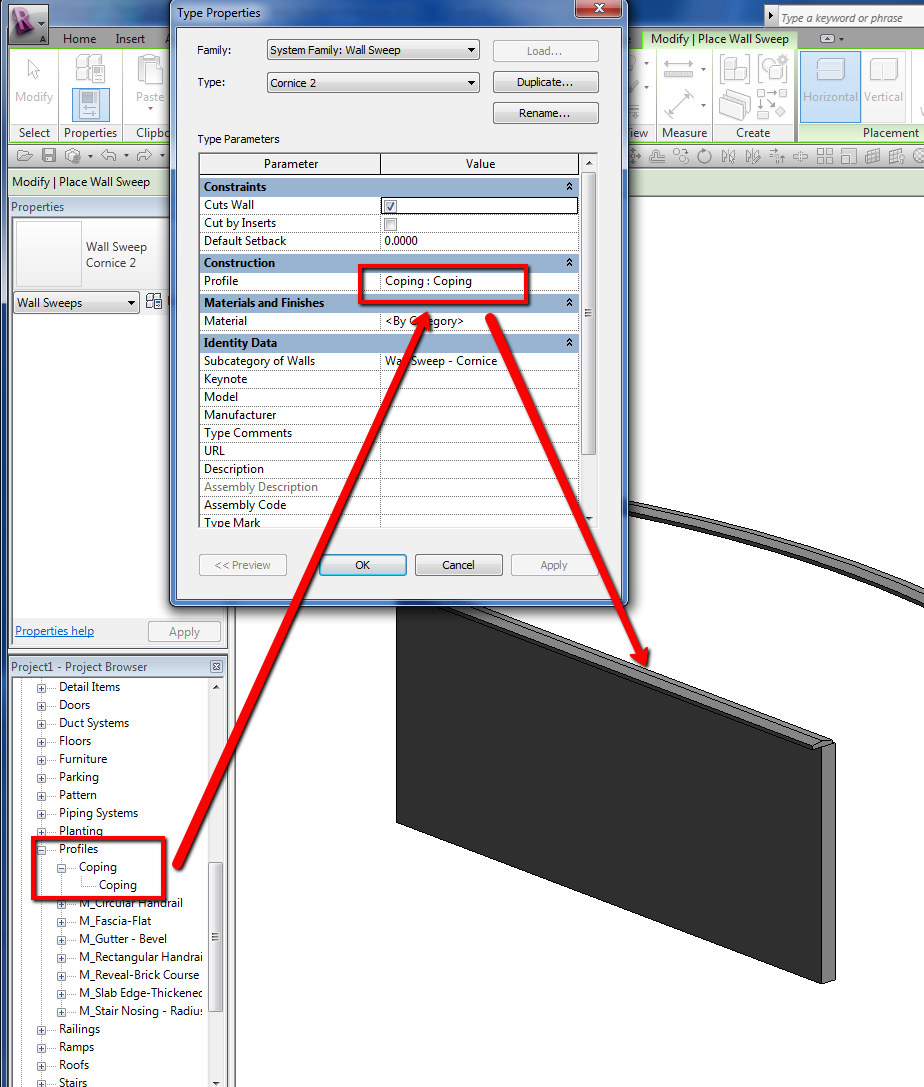

I don't have any problem in both cases

I cannot figure it out.  I went into 2011 and had no problem loading the profiles.
I think it has to do with having the hardware acceleration on/off.  Other wierd stuff was happening when i had it on: like I could not select a family (door, window) and of course the realistic view would work, but when I turn it off all is good with the exception of the realistic view not working.
So I turned the hardware acceration off and opened the file again and easily loaded the profile and no problems.

I turned off the "Hardware Acceleration", create a new file and did exactly the same thing, no problems....
