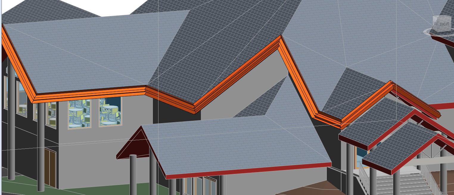

well, if you want flashing, it's already an option in revit which you can add to a roof.  You just need to load in a new profile. Their Fascia tool is better at the job than homebrew families could likely achieve.
If you need this TODAY, i would... (I sound like a broken record, all the threads I've commented in today has been about this) use an in-place sweep where you pick the 3D edge, the 3D edge being your upper corner of your roof.
No need to do this as a separate family.  It's just that much harder to control.
You can still control the purple sketch lines after you pick a 3D edge.  You can drag them shorter along that path, for example.
pic related.  crazy profile for added visibility...
