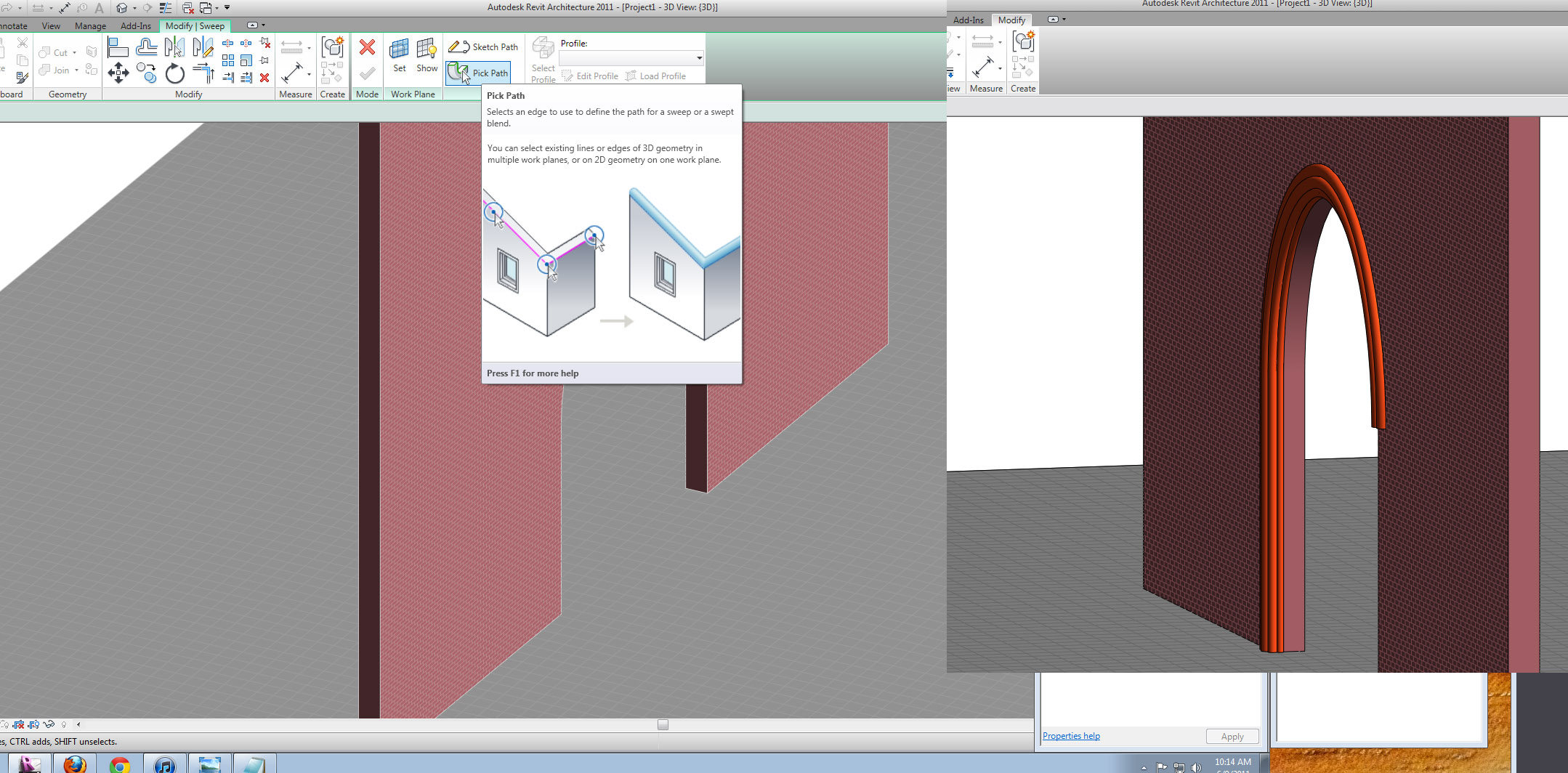

Hey there.  For sweeps, you can "pick path" instead of drawing a path.  Any 3D edge will work.  It's very, very simple, and looks great.
pic attached, and related.
