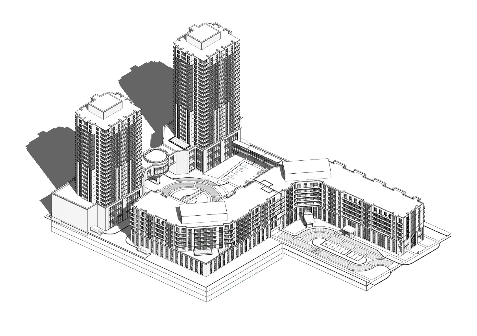

I was wondering if you guys could help me in understanding whether I will have the right tools to do the job I need to get done.
I am working on a project that has 4 buildings linked into a detailed site Plan. My end result would be to render the finished product. I will attach an image for your review.
I am the only computer working on the Design Concept and Save all my files to the comnpany's network. Right now with my current Core 2 Duo Computer, it takes about 20-30 Mins to print full site elevations with sahadows.
The Computer I plan on doing this with has the following configuration:
Originally created in Revit 2011 but I have  revit 2012 installed now.
Microsoft Windows 7 Professional - 64 Bit
Intel i7 990x 12M Cache 3.46GHZ CPU
Asus Sabertooth Motherboard s1366x58 DDR3 motherboard.
Memory (Total 24 GB) 2- Kingston 12GB 3 x 4 GB kit
PNY Quaddrro 600 1 GB DDR# PCI-E Video Adapter
Seagate ST310000524AS 1TB 7,000 RPM with 32 MB Cache Hard Drive
Enermax ECB3070M Mid tower Case
Please let me know whether I am pushing the envelope or whether the above computer should be able to handle the task with relative ease.

Well, the truth is I'm not sure how the CPU components affect the revit program. For example is the video card Ideal or is there another brand or different spec that would be better?
The other thing I'm not sure of is will this do what I need it to do in terms of rendering the 4 building project I attached in the original post?

if you are going to use Revit for High Quality rendering i think it's going to be a time consuming process for the best of computers, period.
Autodesk has list of approved graphics cards at there website, ROI is minimal between the low and the high.

AutoDesk has a list of video cards that will "work" with Revit but there is no recomendations.  There are just too many cards to list.  I suggest you search this forum and the Augi site with your video card name to see if there are any problems listed.
64 bit vs 32 bit makes a big - BIG difference as well as how much memory you have.  As far as rendering times, again, there are too many variables.  Textures, reflective materials, facets all make a difference.

thats a pretty capable system. If that was my computer and my project and I had $2000 to burn on a a GPU I would invest in a Nvidia Quadro FX 4800 or something similar. I have used them in Dell T7500s workstations in the past and have worked extremely well with large models, shadows, ambient occlussion and so on. If you dont have the budget you'll be fine using worksets and detail levels to manage any large model.

You don't need that much RAM.   memory doesn't actually do very much for revit.  If you have over 6 gigs you're not going to run into any problems.
I've summarized revit's draw on a system before, like this:
Processor:  mostly used for renderings.  If you're doing high-quality renderings and walkthroughs, the processor is used to calculate shadows and reflection bounces and this sort of thing.  Going from dual core to 8 cores can make an 8 hour rendering a 45 minute rendering, possibly.
Video card:  This affects the smoothness of your work.  When you're spinning around a 3D model with shadows and shading, or trying to fly around in a camera view, you need a massive video card to keep things fluid.  An good card will prevent hang-ups and lag while trying to regenerate a view.  Consider two "good" cards linked in SLI... that's my goal.  (never buy the best, state of the art, waiting 3 months saves you 500 dollars)
You might consider a 10,000 RPM drive.  faster read/write.
And yeah, you could save a little money on the ram.
