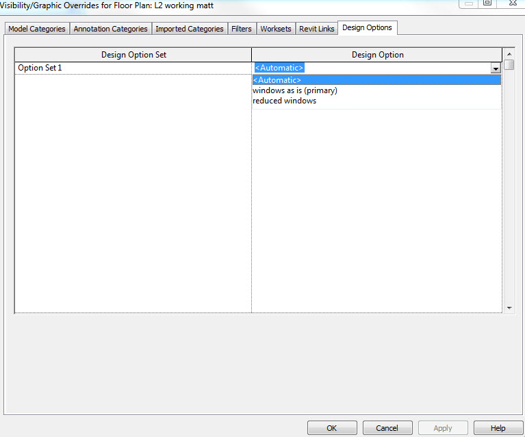

I want to do 3 different design options on the same model.  When I try duplicating a view I alter one the original changes.
How can you do this with the same model having its own views?

In visibility graphics for the view.
The default design option (automatic) is the primary option

Did you duplicate the view then go into the new view and press "vv" to get those options? I only get these 3 less tabs than you

I assumed you were using the design options tool

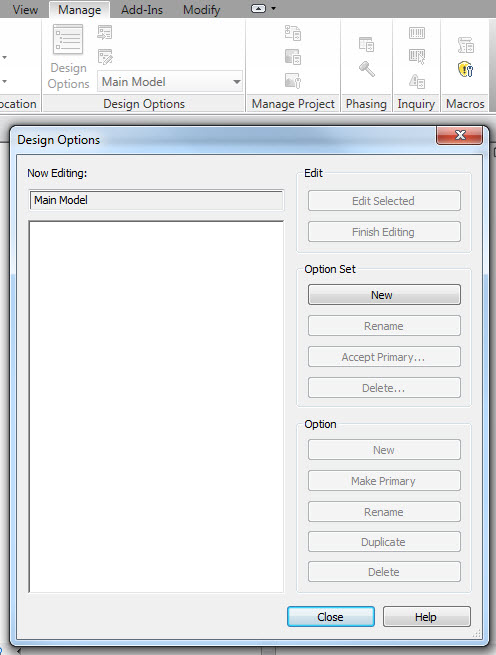

The help in revit is actually helpful which I am really suprised as most programs help is useless. As good as it is I am not. I tried and followed the help instructions I have made 2 design options but I can't seem to be able to view them seperatly I just want to be able to have 2-3 different designs I can view in all view so I can flip between the different designs say in 3D to show.
http://screencast.com/t/sEWhfEVWkNw
Here is a SS of how far I got

Make 1 option set
In that make 2 options.
Its not an easy tool (for me)

That was it that little thing now its all good. Thanks heaps for that mate.

It sounds like you got what you needed.
Just a quick FYI.
Design Options have their own visibility tab in VV.  The primary option will display by default if you do not select it.
Also, you can schedule elements in design options.
Accepting the primary option (when you are finished) WILL DELETE both the other design options and ALL elements within them.  Be careful.  This would be a good time to Archive.
