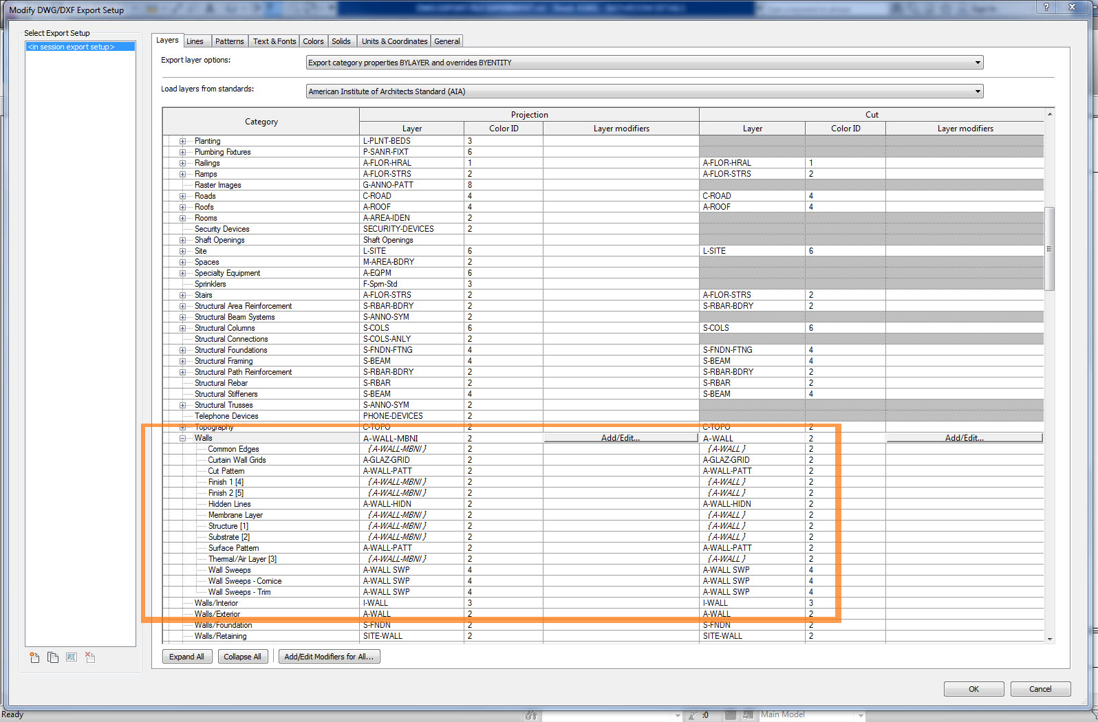

This may be easy but it has me stumped.  I'm devlpoing and export template (2012 revit to 2010Acad) and am excited to see that wall sweeps are their own catagory in the Export Setup.  The thing I am having trouble with is that when I type in a new layer for the 3 sweep options making the a different color and Layer they still export on A-WALL just like their host.  Do I need to use the layer modifier instead of trying to type in a new layer?
Thanks for any help
