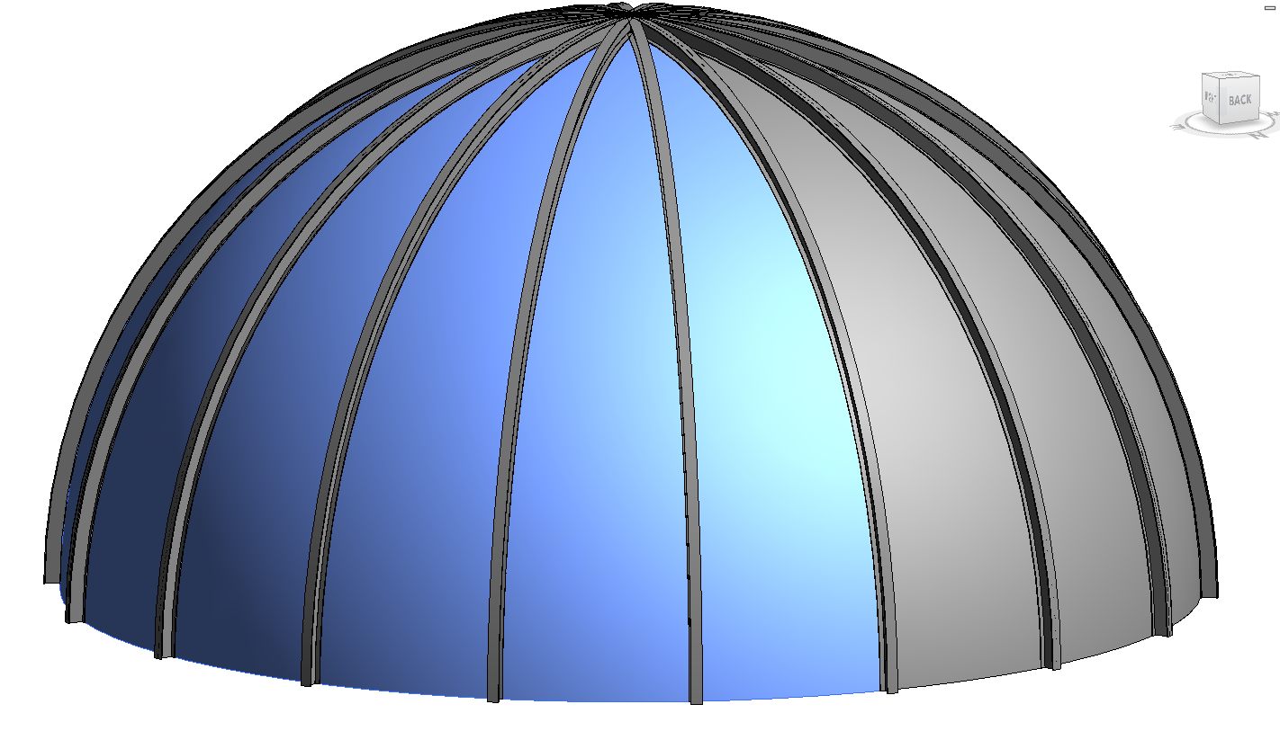

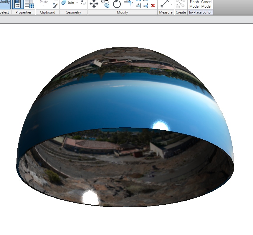

Hey -- if you're making a planetarium, you should try this!  But with a panorama of the stars.
Let me find the thread.. it was..
http://www.revitcity.com/forums.php?action=viewthread&thread_id=24003

The image you attatched is exactly what I am trying to do - except it would be rotated 180 degrees, and be on the bottom half. I have constructed a dome using the model in place > Roof > Revolve, and then done the same thing for the bottom sphere, but instead of using Roof, I used Wall within the model in place selection.
I am however quite confused as to how to construct the beams like you have shown. Do I edit the revolve within the sphere I am trying to attatch the beams, or do I go to model in place > structural frame, and do it from there. Or do I go to Structure >  Beam?
Sorry for all the questions, and I thank you for your time.

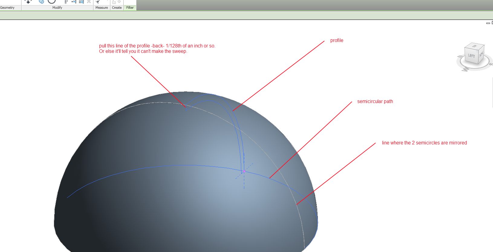

Doh -- I was wrong.  Revolves are totally smooth.  What I would suggest in this case, is making your dome with two semicircular sweeps.  Well, make one sweep, and mirror it.  This will leave a 3D edge that you can use as the path for a beam's sweep.

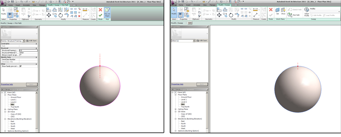

haha, basically.  Start fresh for now.  But -- you just build this in your project not in a separate family, that'll add to the frustration.  You can do it out of multiple in-place families though--in fact, that's better to do for large pieces, such as the beams.  They should be separate from the dome in case you want to make them invisible in some views, for example.

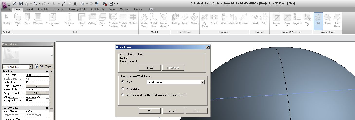

Okay.  so.  The other benefit with doing this with sweeps is that you can move sweeps, up and down or left and right, and rotate any which way, after completion.  Revolves will disobey, so will extrusions.  The other modeling tools are more dependent upon planes than sweeps.  When you select an object, sometimes it has a little icon showing a "plane" like # with a lock in it.  You can unlock this to allow easier movement of you objects in all three dimensions.
Anyway.  SO, just start your dome in floor plan 1.  Sketch the semicircle path, and then go to one of your elevations, or the 3D view, to draw your profile.  what work planes are messing you up?  You might have to set your work plane back to default levels in your view, if you've added new ones at an angle or anything like that. Pic related.

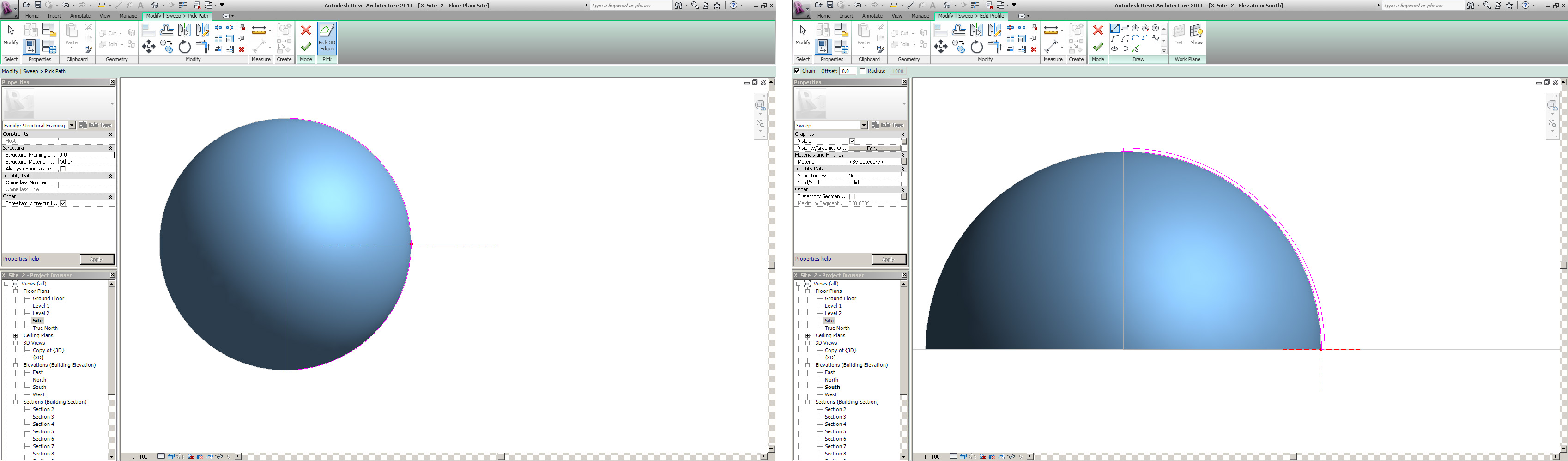

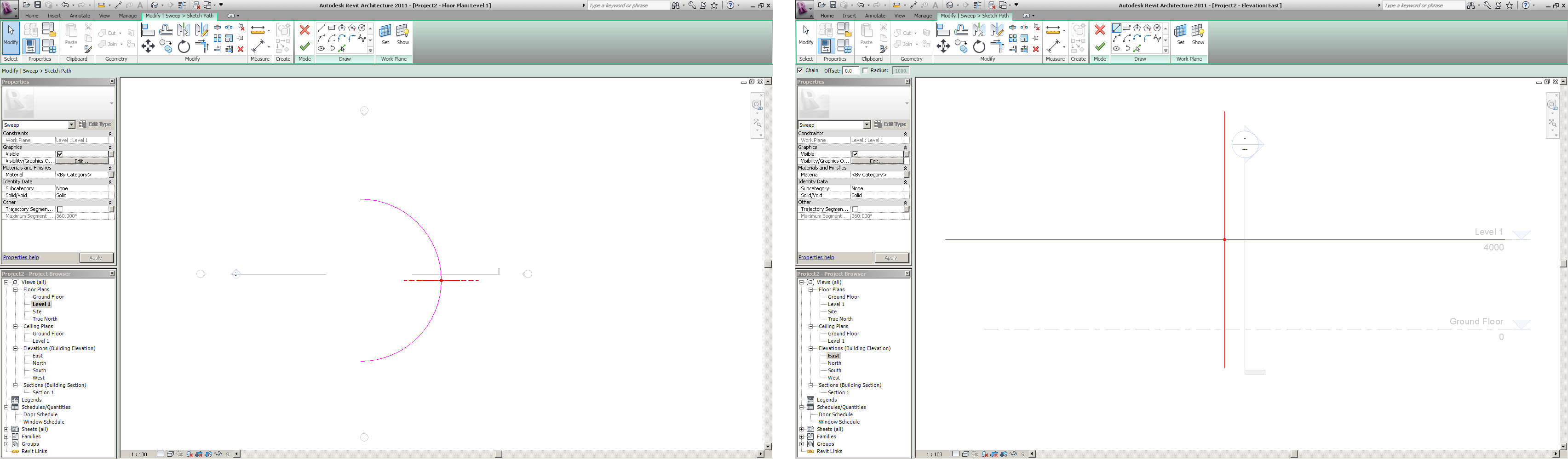

Thanks for the info :-)The problem I have, even now is that after drawing the semi-cicle in plan, when I go the the elevation view, it wont allow me to draw at all.
This is my process: New Project > Level 1 floor Plan > component > Wall > Sweep > Sketch Path > Draw a semi circle > elevation > Stuck......
:-) Thank youRegards DS

You're still in the sketch mode for the path -- hit the green check mark to finish that, which looks correct in plan, and then you can hit another button up there to start drawing the profile.

Thank you for that - I didnt realise you needed to select the Edit Profile button :-) Oops. Thank you for all the help itsmyalterego!!!

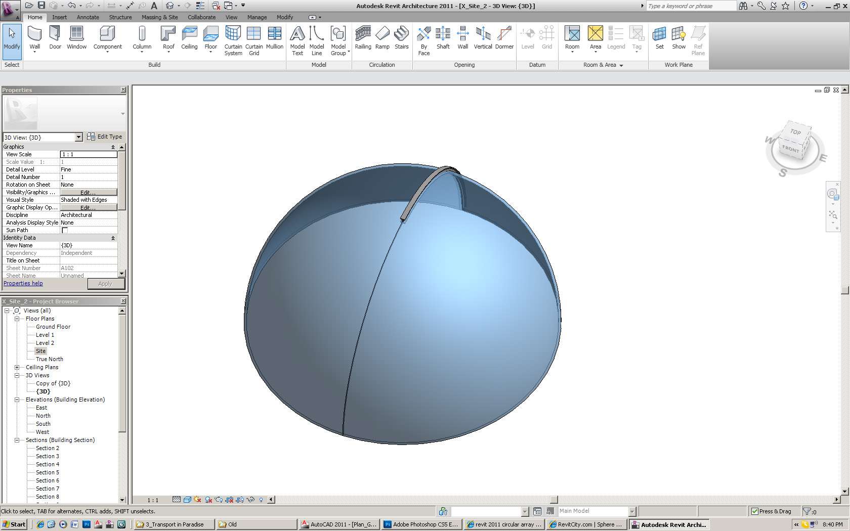

I have however one last question - if you can bear it. In plan, I have gone through the following steps, but just cant seem to finish it:
Home > Component > Model in Place > Structural Framing > Sweep > Pick Path > Pick 3d edges > I select the base, and the two semi-circles creating the sphere > Click the tick > Edit profile >> Go to view box comes up > South elevation > draw a profile similar to the one when making the sphere sweep > click the tick > click the tick again. Here is tells me it cant do the sweep. I seem to be missing the path in which it will sweep, but not sure what stage to do that.

Forget the last message - after some hectic playing about, and some common sense, i figured out that the profile is actaully the I beam itself, and the path is just a single line along the 3d edge. I have however one last question, which seems to be troubling me - how do you array in a circle.
