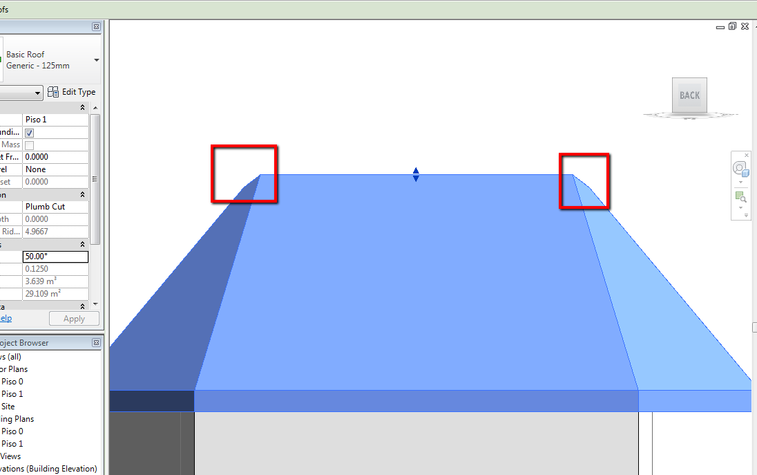

I am trying to do this roof ( see attached ) and with the normal roof method it doesnt make all the hips join at the one point so I have tried using the slope arrow. obviously something went wrong how can i make it pitch from the corner of the walls and change the pitch?

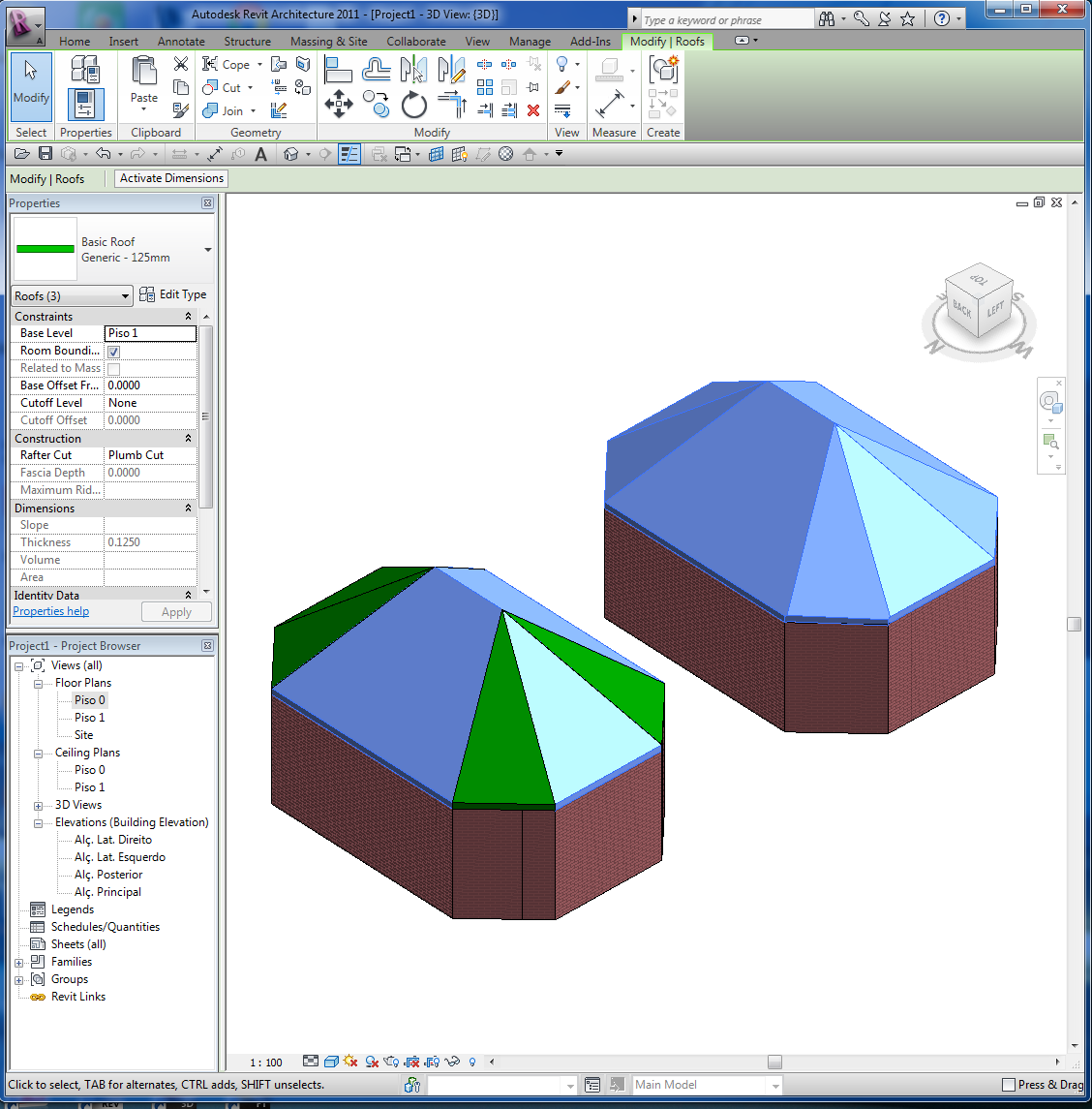

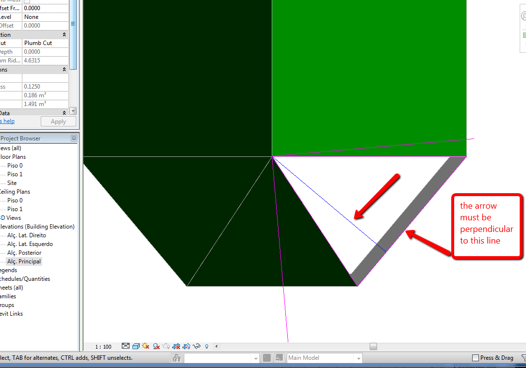

I believe he don't want that roof with that little slope like my first image, right? you want like my second image, correct? So the "slope arrow" must be perpendicular to the roof line.

Thanks heaps for your help guys the file is at work so Im trying to do it at home so the sizes arnt the same. What if the arrows cant be perpendicular as the 45 degree wall is to small in length. how did you create the roof with only slope arrow or with line aswell? In your 2nd picture is exactly what I need just lower pitch can this be adjusted in properties or not as your using slope arrow?

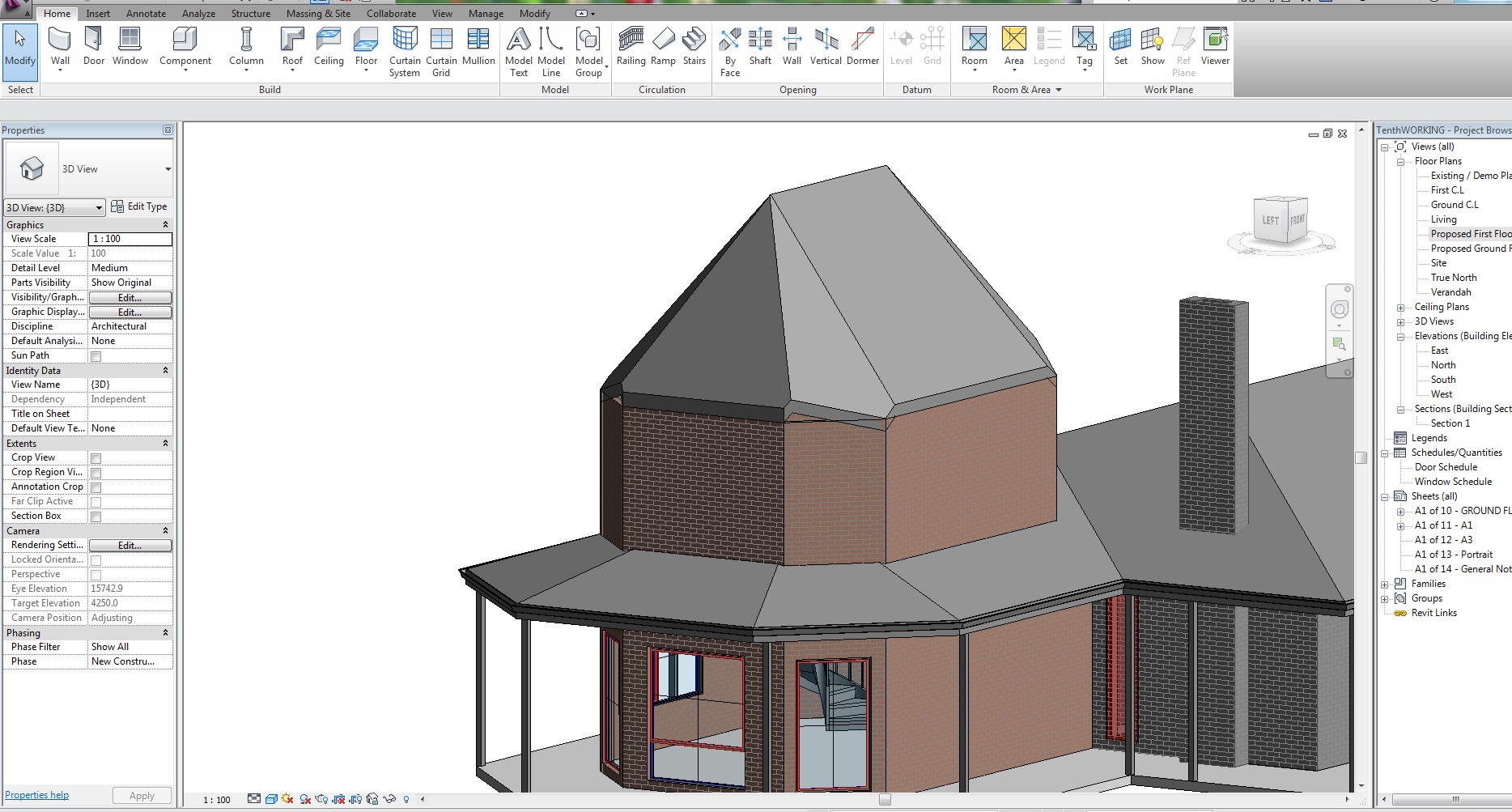

Really wanna do this now. Typhoon how did you draw your roof using only roof slope or lines aswell? It always says lines intersect when I try can you show what you drew to get it. Much appreciated.

Typhoon did it. I was wrong about the length here are the dimensions ( hope it attaches on work pc )

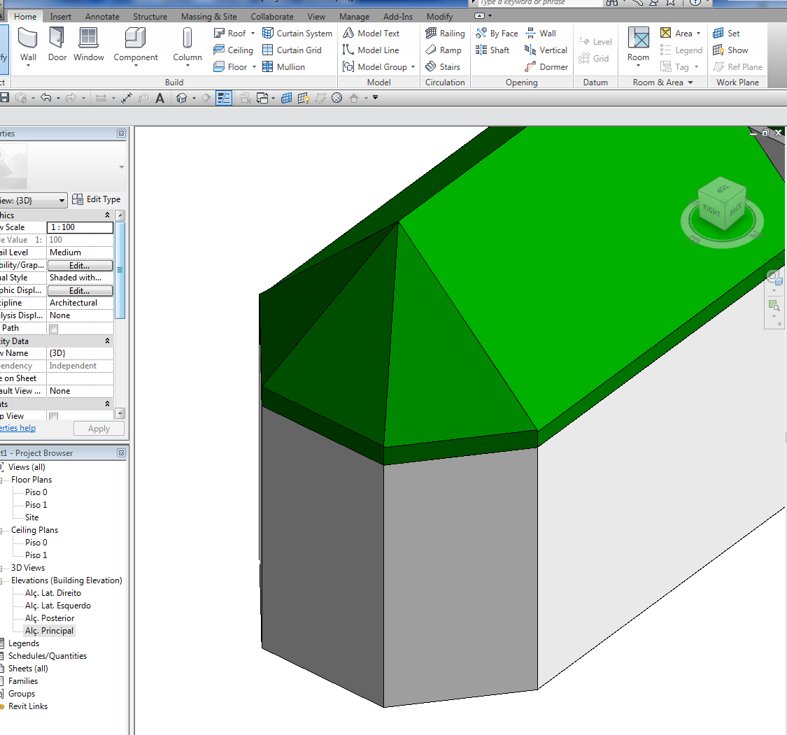

Mon, Jun 6, 2011 at 1:13:59 PM | Roof needs a little work
#14
Joined: Tue, May 22, 2007
5921 Posts
4 Stars: 205 Votes
Here you have, open this file and look

4 Stars: 7 Votes
ohhh legend thanks heaps mate. Much appreciated thanks for your time. Rating 5 from me Puh
