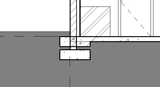

I'm having an issue with a split region wall's foundation.  I've split the wall so that I can have the CMU portion of the wall extend beyond F.F. level.  However when I bring the material I'm not interested in extending back to the finished floor level it creates another foundation (see attached image).
Any ideas on how to get around this? I could use a filled region to draft in the foundation or create an additional wall for the footing, but it'd be nice (and cleaner) to use the same wall.

Thanks for the quick reply.  However, I understand how to edit a wall so that certain layers can be different heights, what I'm having a problem with is when I make the bottom constraints of the layers at different heights it wants to put a foundation at both the levels.  The image I attached is a single wall with the gyp pulled up from the bottom of the CMU, when I place a foundation at the wall, it wants to put one at both the bottom of the CMU and the bottom of the GYP.  Any ideas?

@Cadman -> Thanks for the backup
@jonesstudioinc -> Sorry, was starting with the approach you'd want to go, now knowing that you have done this, and knowing that the gyp is what is causing the issue, just remove the gyp from the wall construction, and place a new wall on top of this one built with gyp, or do as I did for my basement walls, I had a 5/8" layer of gyp as its own wall, and thus the footing only attached to the concrete wall.  I've found in Revit that sometimes its easier and better to have several walls combining into "one" wall, vs the more complex approach of actually constructing it in the wall.
So to summarize, remove the gyp from the equation, footing should now work correctly, then either place a new wall on top which has gyp built into it, OR make a wall which is nothing more than gyp and abutt it to the wall which has the footing.

Figured that'd be the way I'd have to go! Thanks for your help!
