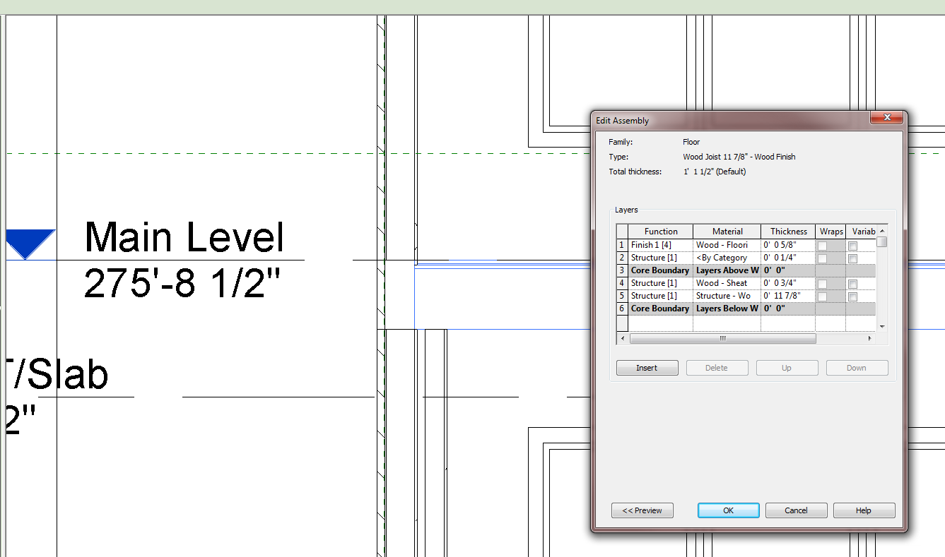

I had thought that when you create a floor, assign the function, that the level it will sit at will be determined by the core boundarys. If you have the finishes above the Core Boundary, and the structure within the Core Boundary, and then you set the contraint to (let's say) Main Level, the top item in the core boundary would sit at the Main Level.
Am I wrong about this?

Not sure if it is different in the structural package or not, but what you should do to make your life simpler, is add in an extra level, OR define your levels as Face of Finish.  If you want your slab to be associated with say, 1st level, and yet you want the finish to be above the level (i.e.- you are mapping it to face of slab, not face of finish) then you need to modify the height offset from level and offset it by the thickness of your floor finish...

Structure is set up a little different than architecture. When placing beam and beam systems etc. they generally will be drawn with the top of beam at the level of concern. Then the slab or other floor system will need to be established above it like Trent said. I usually do not place my finishes in the floor system model but rather place them afterward as a separate floor because I usually have many differing floor finishes i.e. tile, wood, carpet vinyl etc. on the same basic floor type.

mbsteve: that is what I will do. Good plan. Thanks for clarification.
