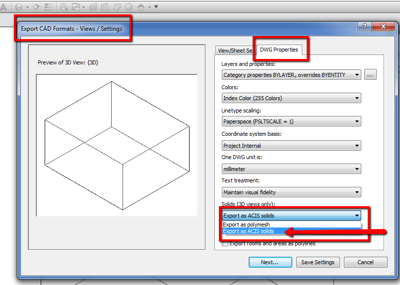

I am having issues exporting solid models from Revit Architecture 2010 to AutuCAD Architecture 2010. Whenever I try to export a model from Revit, it comes up as a poly mesh model. Is there a way to export it as a solid model?
Also, is it better to export Architectural models directly to AutoCAD or is it better to export it to IFC and then convert it into a DWG so that it retains th information?
Mon, May 23, 2011 at 12:41:08 PM | Exporting Solid Models from Revit to AutoCAD
Joined: Tue, May 22, 2007
5921 Posts
4 Stars: 205 Votes
Because you are exporting that with "Polymesh" and not with "ACIS" solids.

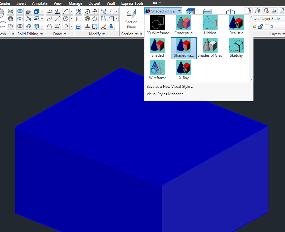

I did export the model as ACIS Solids; but it is still showing me the wire frame model in AutoCAD.
Wonder what I am doing wrong here.
Mon, May 23, 2011 at 12:58:48 PM | Exporting Solid Models from Revit to AutoCAD
5921 Posts
4 Stars: 205 Votes

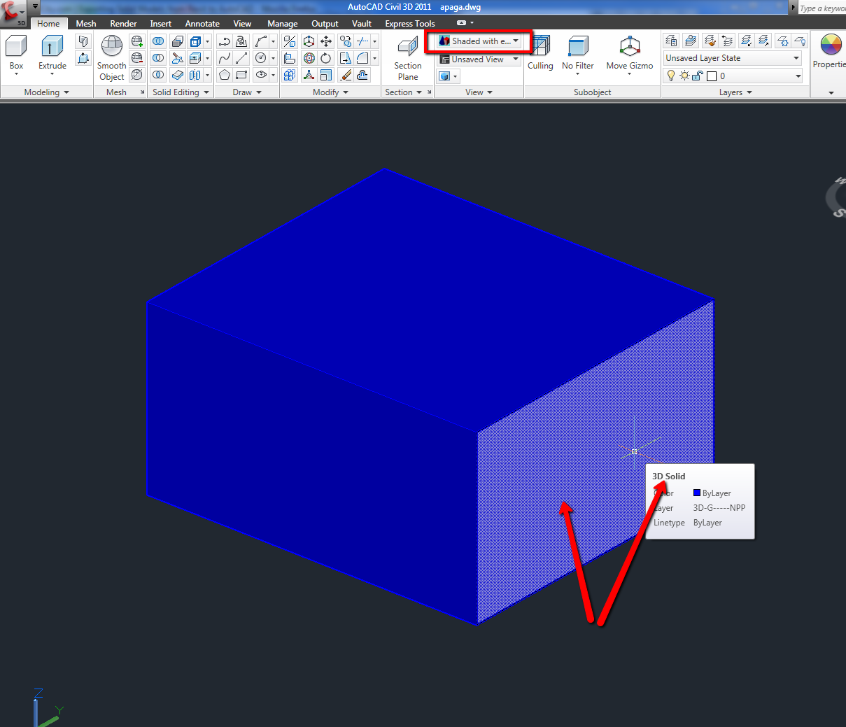

Well, I don't have any problem with that, just change your "visual style" like you want...
