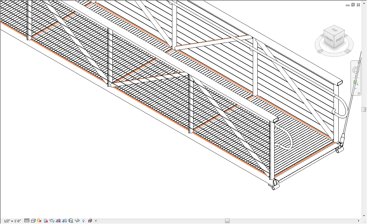

Does Revit Structure have a family for bar grating? I cannot find it. I need grating for platforms.

I have made several of them this is Grating Pacific FRP
Wed, May 18, 2011 at 11:42:11 AM | grating
mbsteve
mbsteve Avatar
Joined: Fri, Sep 22, 2006
759 Posts
4 Stars: 13 Votes
Sorry,
File was too big. Here is a view.

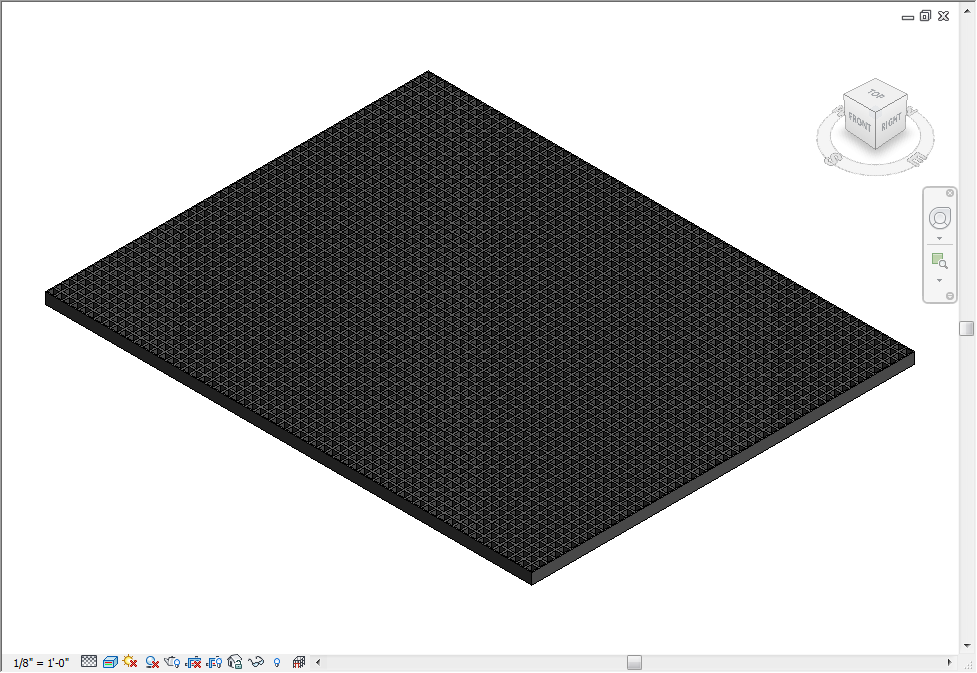

@ mbsteve,
did you ever end up putting that grating on the site? I could use that for Revit 2011.
Fri, Jun 15, 2012 at 12:38:24 PM | grating
mbsteve
mbsteve Avatar
759 Posts
4 Stars: 13 Votes
The picture below is a T shaped pultrusion modelled after Grating Pacific, T1215

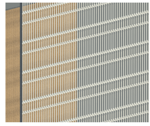

Fri, Jun 15, 2012 at 1:12:32 PM | grating
This is the built in material called "Wood Stockade" applied to both sides of this 1-1/2 inch wall.  I did not set any transparancy to the material - no need to and you can see through it in renders.  NOT IN NORMAL VIEWS
Fri, Jun 15, 2012 at 1:40:30 PM | grating
BTW - If you do a material like this, you can still set it transparent with a pattern for non-rendered views.

Those are both great! I'm actually after the FRP type, that you had posted a picture of first. Did you happen to upload the revit file earlier? I did a search & couldn't find it.
