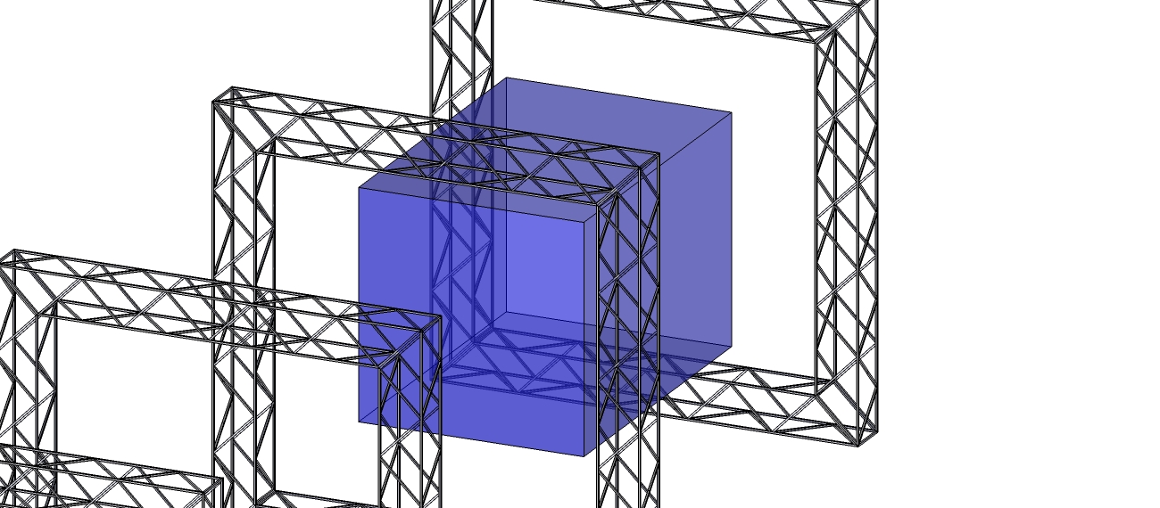

I am in need of creating a kind of box section truss system, but I am new to revit and I'm problems manipulating the trusses to create what I want. (I'll attach a sketchup-export which shows what I am after!)
I've tried loading truss familys and then (sketchup-style) duplicate and rotate, which didnt work.
I've also tried creating a new family, but there's simply too many question that pop up. (For example how to i create a truss in which the inside members keep generating as I pull the truss to become longer) Also it seems like that tool only works in 2D, so to speak, as I can only create a top and bottom member.

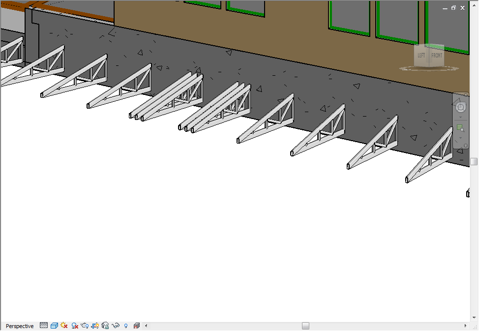

If this truss is repeating, as your sketch up model indicates, make a generic model of it. Then import and array.

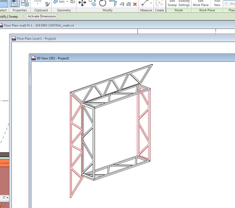

For being new to revit you're able to articulate yourself well and take on ambitious things.  Scalable trusses, true parametric families that add more trusswork as you lengthen it are very complicated to get to work right. I avoid it still since in-place families are more efficient timewise for most of our projects.
I think, you mean, like mbsteve is saying, that you want the trusses to duplicate?  or do you really mean stretch?  Are there going to be any connecting members between the boxes?  Because that would be more hard.
SO, assuming you only need to build one box, which is repeating; from what I can see there are only THREE separate faces that need to be drawn, the copied, rotated, moved, etc.  yay.    From my experience, sweeps are the easiest form to manipulate.   Just draw a sweep with a very short path, and a complicated profile.   Finish thess three, then jump around between elevations and floor plans to rotate and move them into position.

the pic you sent me seemed to be your average "2D truss", which has been arrayed. in my case i would need two trusses next to each other and then one on the top and one on the bottom, in between them, to join them and hence create a box section truss system. don't know how to do it though.

This is a rush job since I'm at work Puh  but this is what I'd suggest you do for building an in-place box truss that you can copy/array as you wish.   Like I said, as three different panels you copy/move/rotate to build your box, here's an example of a couple faces selected.

Ahh - no.  importing families will likely be too much of a burden.  Sweeps, extrusions, revolves -- these are some of revits built-in modeling tools.
Extrusions might sound like they make the most sense, but they're a little more finicky than sweeps in a couple ways.  Sweeps are extrusions, where you draw the path, but they're a little more free from constraints and easy to work with.
If you go to the home tab --> Component --> Model in place, you can start your own family, using these tools.

Okay, well, the basic thing you need to take out of this is that you can make your own "in place" families, families that you don't need to load into the project.  It's very nice, because you can build exactly what you want, the downside is that families your build in place are less flashy and "smart" than most you'll find available for download.
But when you have something like your box beam, odds are very good that nobody has modeled something like it before, and so making it yourself is your only option.
In every-day work, I do a lot of modeling.  Custom family-building.  So the modeling tools are pretty handy to get good at.  And since you know sketchup, it should be a pretty easy thing to get into.  There should be lots of Threads on this forum about "Model In-Place" and such.  Don't confuse it with "conceptual mass" though--that's for more complicated organic forms.  good luck!

I agree with itsmyalterego an inplace family is just fine for the 3D trusses you are trying to create. To be technically correct your vertices should line up across from each other. Plan the layout of the trusses carefully.
